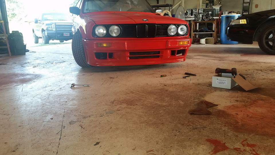

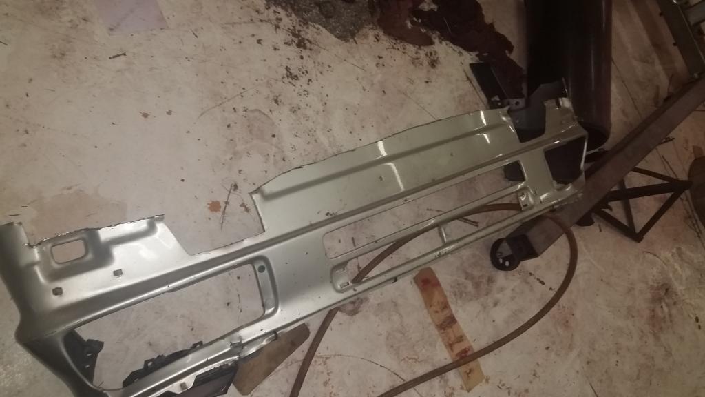

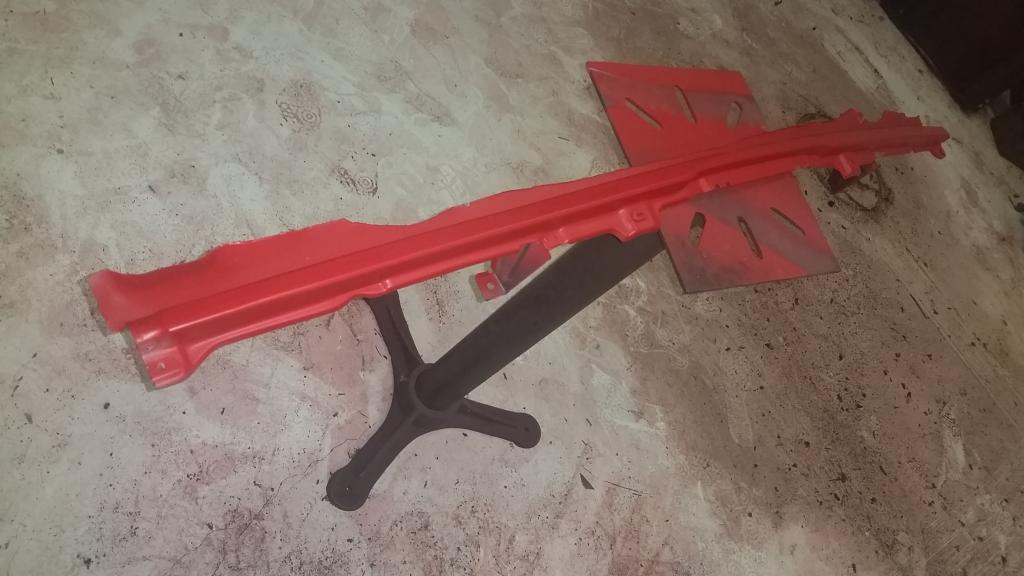

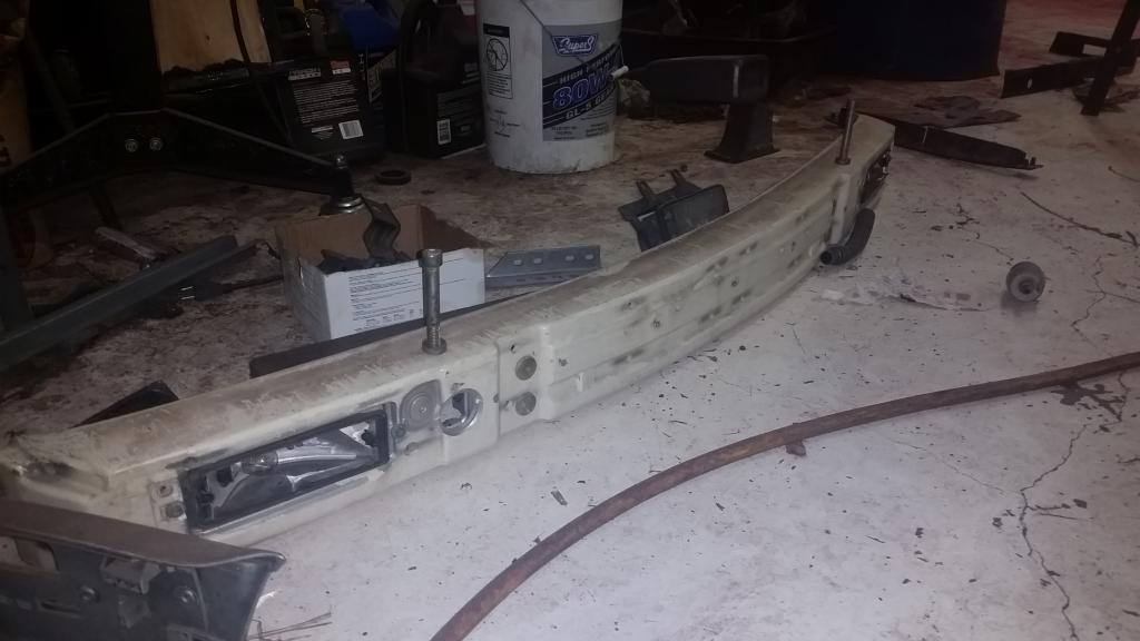

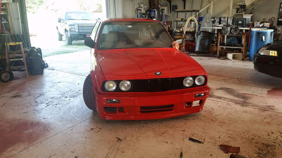

    Hi I was installing my mtech bumper a little bit ago and I couldn't find any threads about how to easily install them. So I started to make brackets and all sorts of stuff buy then I figured it out. So I used the single piece bumper and I have a post diving board car (89) so I am not sure how well this will work when you have different stuff. Any way what I fid is I pulled the plastic part of the bumeet off of the white part. So the inside of the oem bumper is what I use to mount the mtech onto. It just slid on, then I used the old metal valence and cut the top off to mount the grille, fenders and take up that small gap. Then you have to put the turn blinkers in the white part of the bumper before you put the mtech on. And you have to put the orange cover of the blinkers after the mtech bumper because the orange is too big to fit through the blinker hole.and that's it. I'll post some pics
