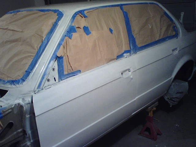

    It's alot of work and alot of putty, but it can be done. I only rolled 3 coats of paint on the car, that's why it's a little sparse.
    Breakdown: I think it works, if it's done the right way and good prep is taken into account. Don't do it unless you will have subtle sideskirts such as "is" sideskirts or I'm putting small zender skirts on mine.
    Here are some pics.

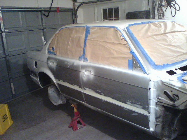

              Talked to the prof about it (I'm an auto-body student) He said that mud WILL crack and fall out, so I'm gonna weld in a wedge to ease the top part into the crease, leaving two creases that will run the length of the body. Then use as little mud and glaze as possible to smooth it out.
              should be hotness (like the first pics) when I'm done. Also shaving the antenna, anybody find a good way to replace it without being big and ugly?
