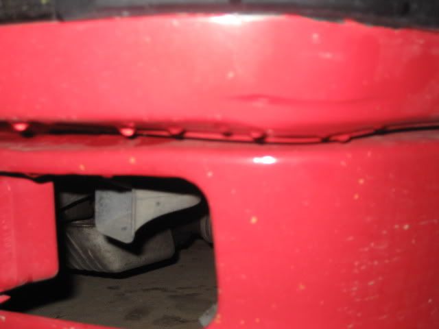

    Hey guys, my bumper has a gash in it that causes the bottom to pop out a bit, and I was wondering if you guys thought it was repairable or if i should get a new cover (which I really don't want to do).

    yes, if you have the skills

      Get some 80 grit to scuff that up and some plastic repair. Finish it off with some Polyester putty and 180 grit, primer, block w/ wet 400, paint. I would use some plastic repair webbing in behind it for structure integrity. Find a local autobody supply place and they should be able to help you. That isn't a big deal at all.
