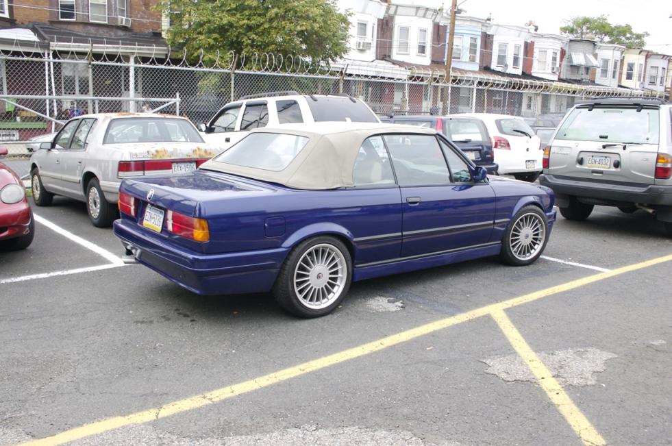

    The only pic i could find over the vast expanses of the interwebs.
    If anyone else has one PLEASE post up!

    I think the side skirts on the car in the photo are most likely fiberglass which have been trimmed to fit closer to the body.

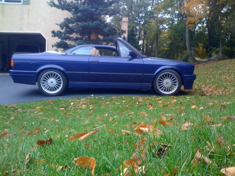

        i have just the skirts on there too. I mounted mine just below the lower trim that comes on the verts. I looks clean

          Are those real or replicas? Sell me your wheels NOW!!!!:hitler:

            they are reps the wheels could be traded no prob for something BBS and over 15"

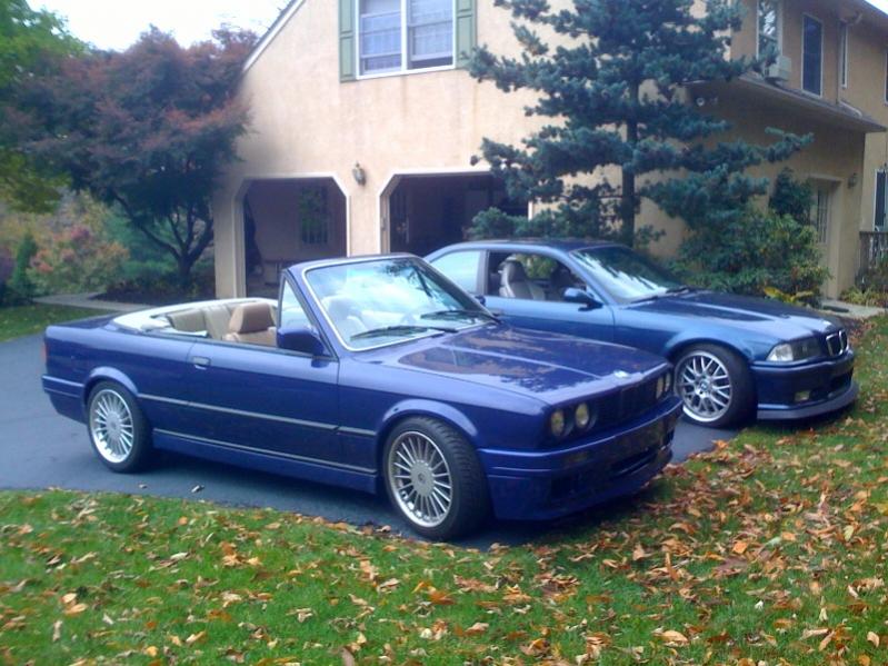

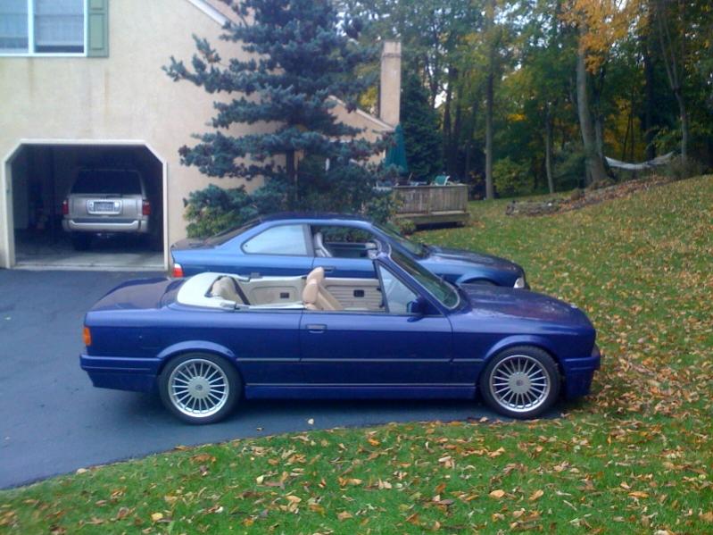

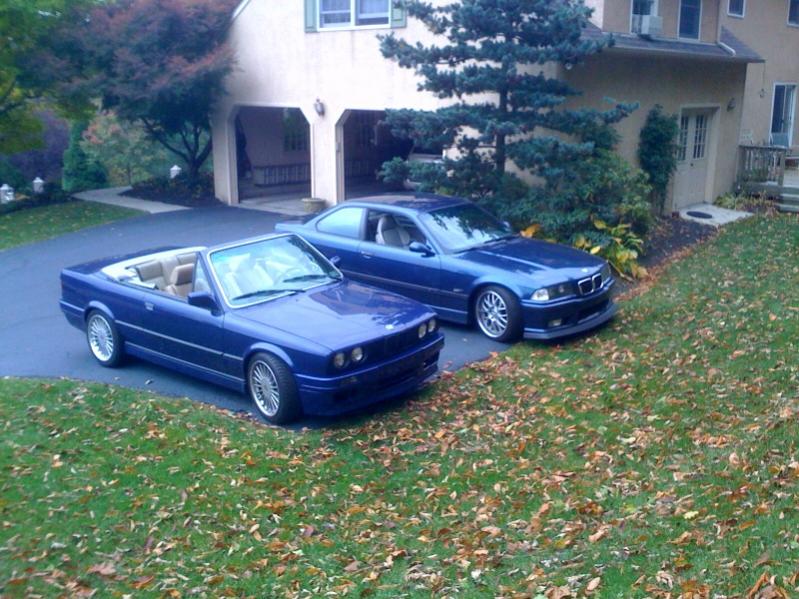

                      Here are a few more pics these have been posted before but it's all I have on my work computer. The other car is my buddies 95 M3 with a good bit of work also..
