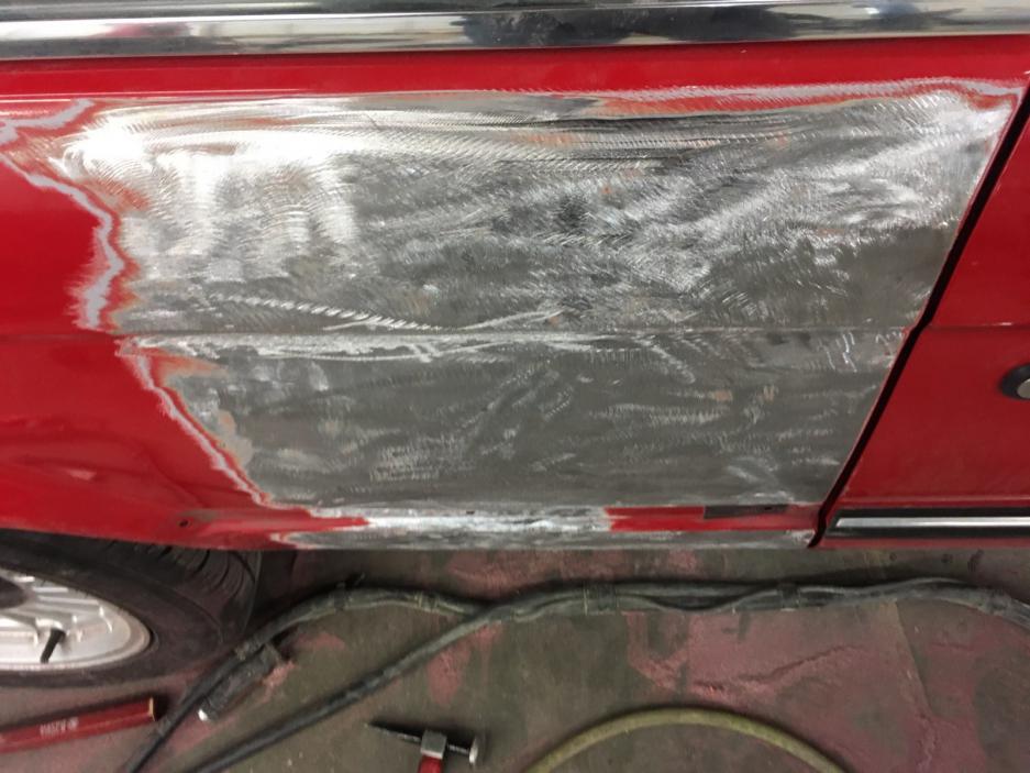

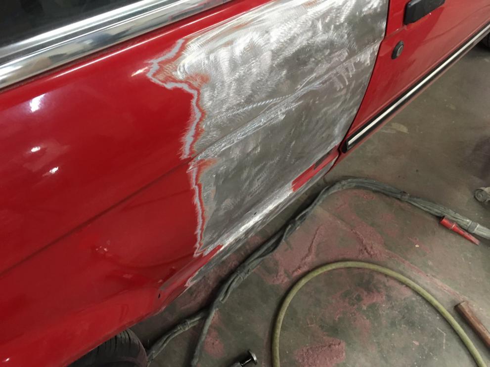

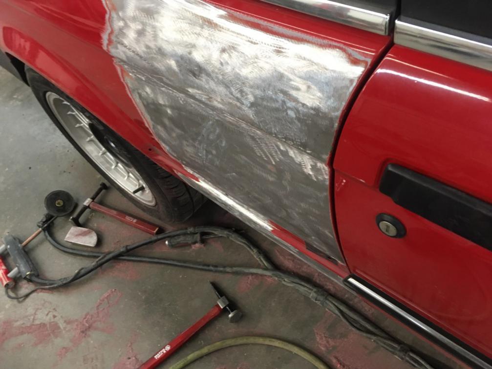

                        Following up after being away.
                        The body shop we picked did a great job, perfectly straight, and nice paint. I'm impressed. Came right to their $2700 estimate, mmoney, so yours should be in that ballpark.
                        They pushed it out from inside, pulled the crease out from outside with studs, hammered, and did some metal shrinking to flatten it out.
                        Click image for larger version  Name:	bare1.JPG Views:	0 Size:	79.9 KB ID:	9915002
                        Click image for larger version  Name:	bare2.JPG Views:	0 Size:	85.6 KB ID:	9915003
                        Click image for larger version  Name:	bare3.JPG Views:	0 Size:	83.9 KB ID:	9915004
                        Just out of paint booth.
                        Click image for larger version  Name:	new1.JPG Views:	0 Size:	68.2 KB ID:	9915005
