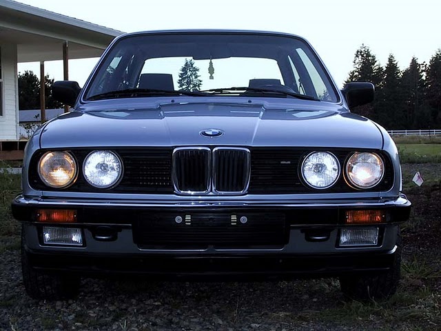

    Is this a pic of your car as-is?
    I always liked the stock euro look. Mine will look just like that, except the yellow fogs.
        Yes, that's how my car sits today. I'm looking for something a little lower and more aggressive. The side profile, with the slant, leaves me a little cold. Not the best pic, but you get the idea.

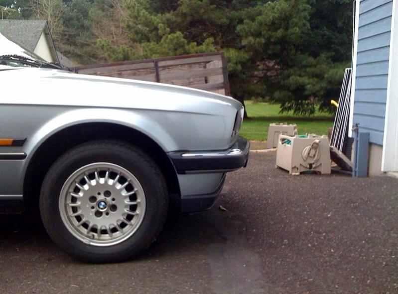

                edit: yeah, that angle isn't very flattering. Is there an engine in the car? Or maybe it's all that lightness you added with the Euro bumps. Either way, that reverse rake is horrid. Go with the coilovers, then you can adjust to your heart's delight...
                See? vvvvvvv
                My bad, I was referring to the angle of the valance, see below. As far as the 4x4 look, that is first on the list to correct. This is a street car so I won't be going too low but I will be lowering some. Being a 323i, it is lighter than other m20s.
