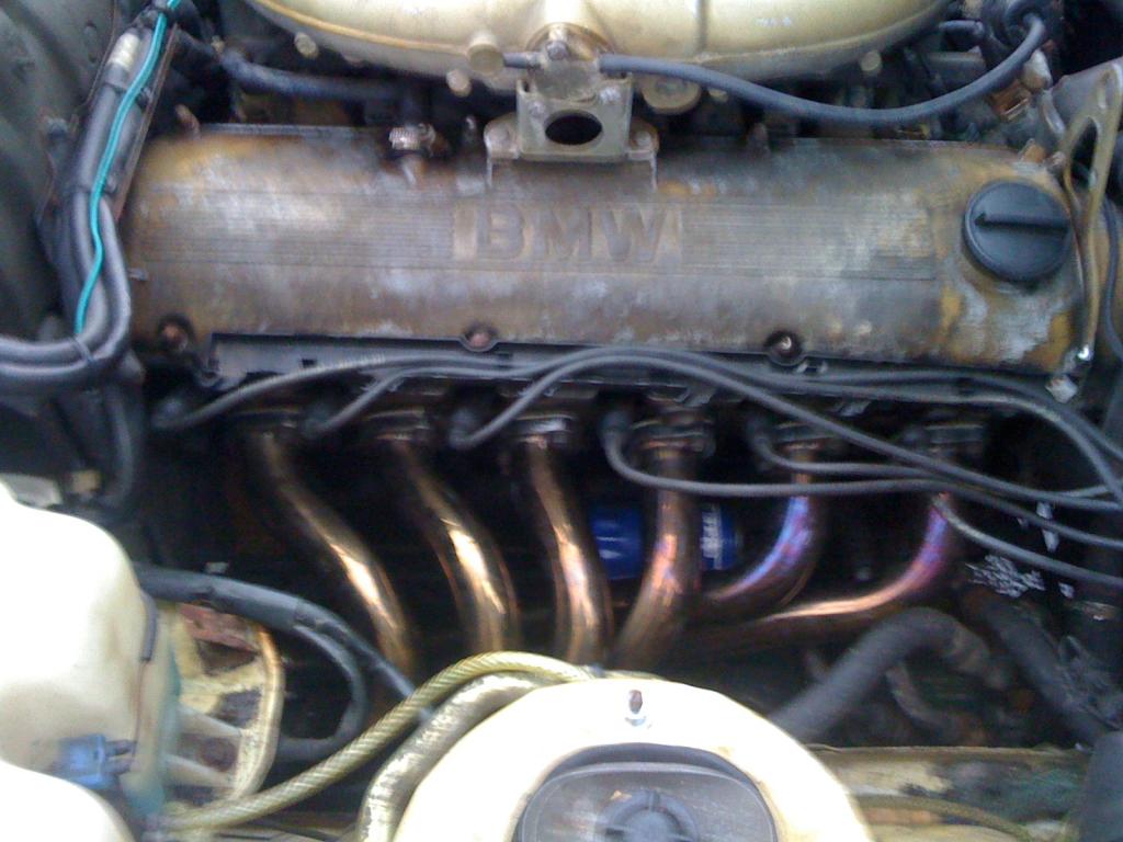

    I have that stupid yellow wax all over everything in my engine bay! Got any tips about how to get it off?

    wire brush

      well i wanted to do the shock housing and not scratch them up, its also all over the plastic and other things as well.

        curious about the plastic as well.

          mine was horrible, and i soaked it in simple green then used a medium strength wire brush

            try using mineral spirit or paint thiner and scrape it with a plastic scraper it should come off then clean off the paint thinner with carb x or brake wash

              How to Clean Cosmoline
              By Meg Jernigan, eHow Contributor
              Cosmoline
              Cosmoline is a viscous petroleum distillate used as a corrosion preventative and surface protectant. It has a consistency similar to petroleum jelly and is formulated to adhere to nearly any surface even under extremely high or low temperatures and prolonged exposure to water. Cosmoline was used by the military for long-term protection of vehicles and firearms, and it's used in marine and agricultural settings to prevent the rusting of components exposed to harsh conditions. Removing Cosmoline can be a challenge because it's so tenacious. Follow the steps in this guideline to clean Cosmoline from any material.
              Difficulty: Moderately Easy
              Instructions
              things you'll need:
              Mineral spirits
              Bucket
              Rags
              Small brush
              Gun cleaning rod and fabric bore mops
              Detergent or oil soap
              Rubber gloves
              1
              Disassemble the item to be cleaned as necessary to reach internal areas. Items as large as trucks were frequently dipped in molten Cosmoline so that it would penetrate as much as possible.
              2
              Mineral Spirits
              Soak small metallic parts in a bucket of mineral spirits. Wipe the Cosmoline away with rags or small brushes. Repeat as needed until the part is clean.
              3
              Wipe down larger metal items with a rag dampened with mineral spirits. Replace the rag if it becomes saturated with Cosmoline.
              4
              Bore Mop
              Use a cleaning rod and fabric bore mop inside firearm barrels. Saturate the mop with mineral spirits and clean or change it frequently until all the Cosmoline is removed.
              5
              Heat non-metallic items, such wood or rigid plastic, in your oven at its lowest temperature to liquefy the Cosmoline. Don't allow the temperature to reach over 150 degrees. Remove the item and wipe it with a rag, and repeat the process as needed to remove most of the Cosmoline.
              6
              Murphy Oil Soap
              Use a mild detergent solution or oil soap on a rag or brush to remove the final traces of Cosmoline from non-metallic items.
              Read more: How to Clean Cosmoline | eHow.com http://www.ehow.com/how_5251388_clea...#ixzz1HNgzq3tx
