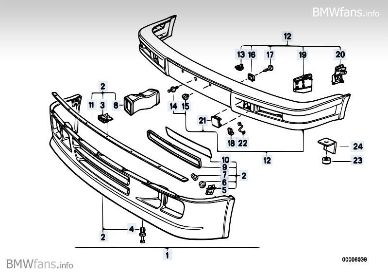

    So I need help figuring out which nuts/bolts/screws I need to install the front mtechII valence onto my 89 e30. I will only be getting the valence and use my stock bumper. I tried doing searches and couldn't find the info I needed. If anyone could help how many #2's, 3's, 4's, etc.. I need to install JUST the valence I would appreciate it. Thanks

    Yeah, i wish there were some instructions posted somewhere. I have a NIB front valance kit that comes with more parts than the diagram.

                  i just checked out the pdf and it gives instruction for just the sides but not the front

                    how about 3 thru 7 + 11? I once mounted one without any of the dealer stuff. It just sits on top of the late valance. I once used nuts/bolts instead of the '4's and maybe a screw thru the side of the spoiler on each side instead of 5-6-7 and just used a few "L" brackets instead of '3's. It's all clear once you get the spoiler test fitted.
