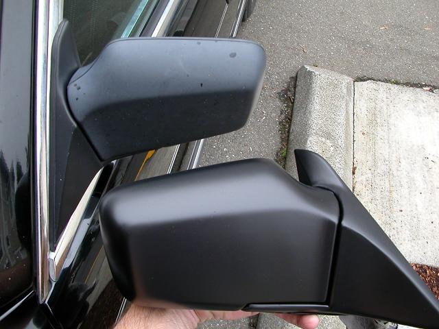

Here's some duplicolor results. I painted the rear window trim and side mirrors today. There was some pitting in the plastic which would probably benefit from some light filler, but overall after sanding and such it came out pretty smooth IMO. Much better than before in this comparison shot. Now just to see how long the stuff lasts. I do a lot of highway miles, so it will be a good test in a few weeks.Jason,

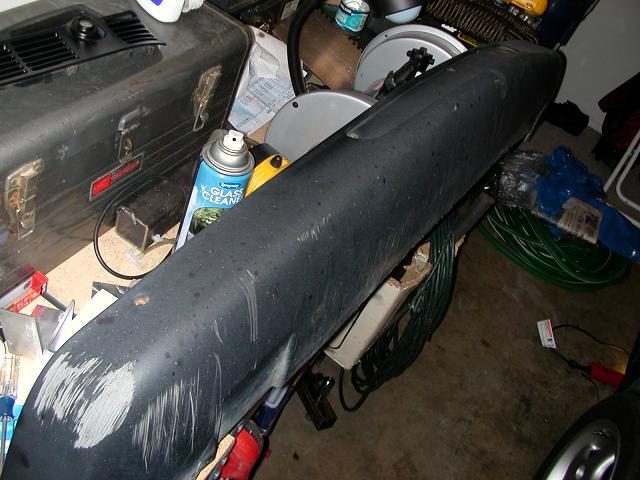

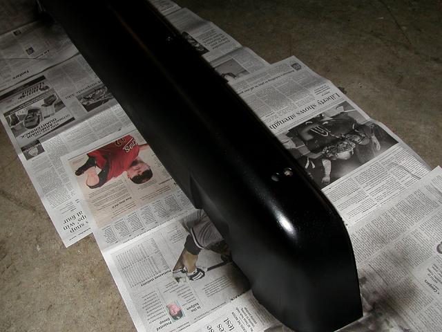

I tried out the Duplicolor "Bumper Coating" on the lower valance as it's supposed to be a more flexible coating designed to take a beating. I figured the lower valance is one of those areas.
I'm not certain I like it yet. It took much longer to dry, and was very prone to running. I had to make extra light coats. Fortunately I experiemented on the back side before coating the front. We'll see how this holds up before I apply it to the front bumper strips, and possibly the grills as they get a lot of rock hits. Here's a before shot:Jason,
