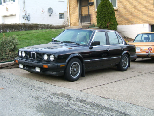

        I painted mine gloss black and used trim paint on the plastic trim pieces (removed them to paint). I sanded the bumpers with a vibrating block sander (from about 60 grit down to 400 or so), rattle-can etching primer, then a few coats of black Rustoleum. Then I wet-sanded the orange-peel (just on the top) down to 1500 or 2000 grit, and followed up with an orbital polisher and polishing compound. It turned out well, although single-stage black paint still is not the most durable ever. Overall pic below--I don't have a close-up of the bumpers.
