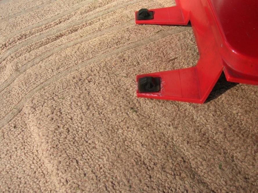

    I have a 91 E30 318is.
    Down in the front valance below the front bumper where the fog lights would go, I have the factory fog light delete plates (see att pictures).
    I need the black plastic tabs that hold these plates in place. Does anyone out there have any of these new or used ?
    I need them asap, much appreciated.

    getttho option would be zip ties. all my little clips broke so i have zip ties and u can't tell if you have a front lip on your car.

      You can just bolt them on with the same bolts the fog lights use. That's how mine are mounted.

        yeah, you don't need them. use the original bolts.

          For those that have a car that came with fog light delete plates from the factory and therefore do not have hardware for the fog lights, the PN for the clip for the fog light delete plate is 51711933759
