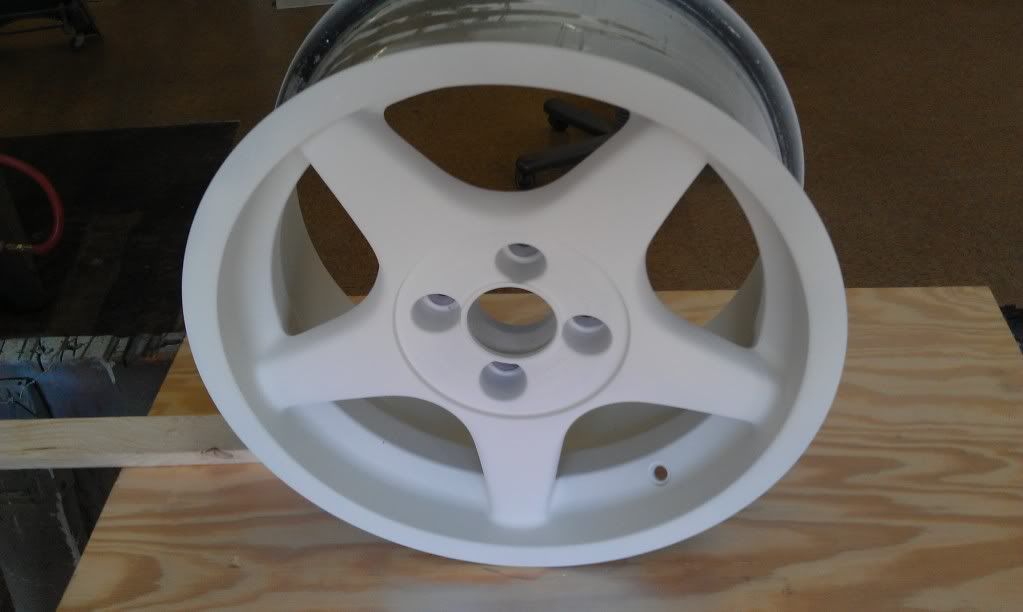

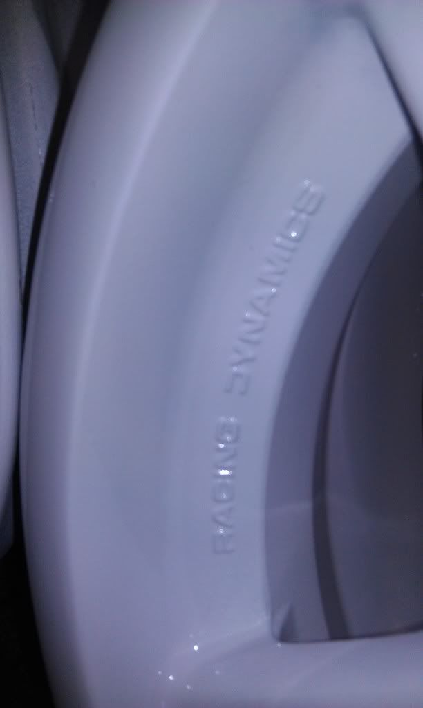

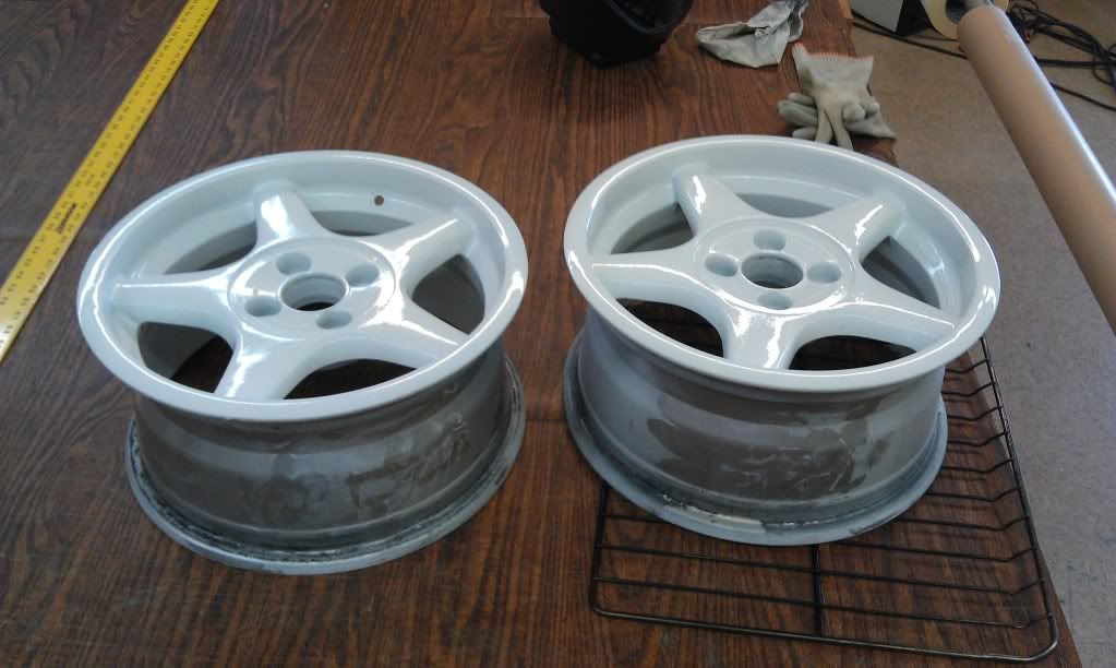

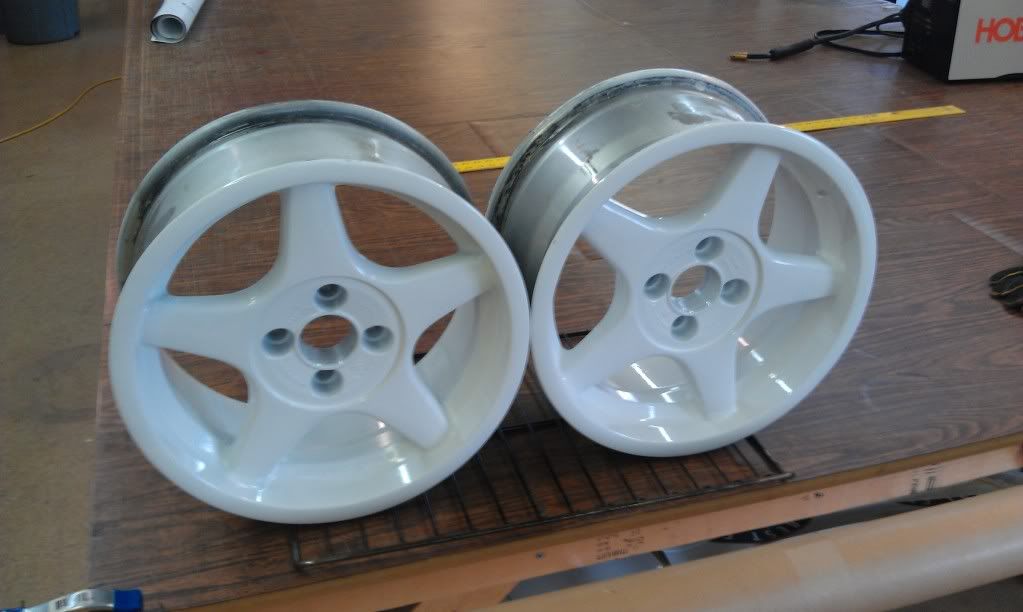

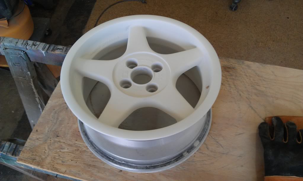

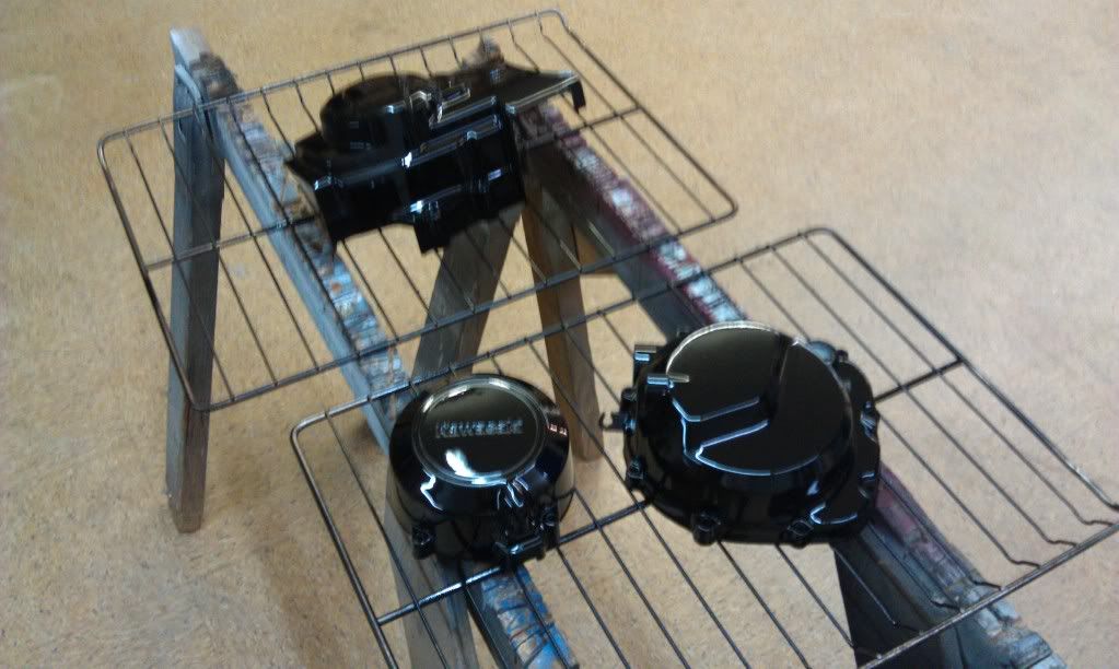

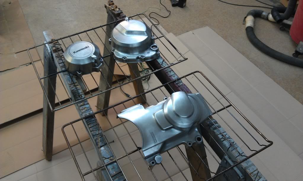

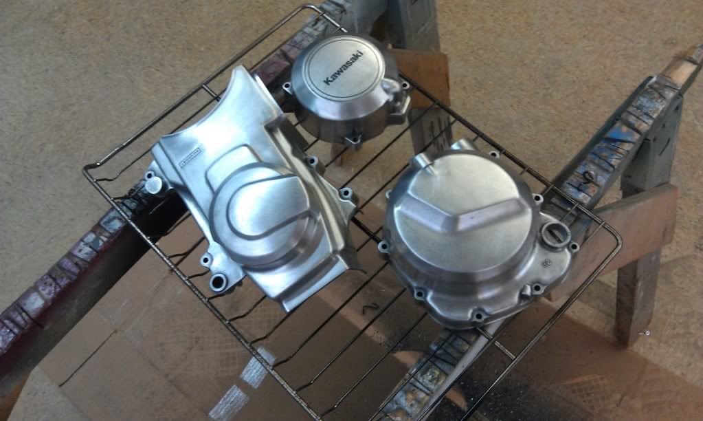

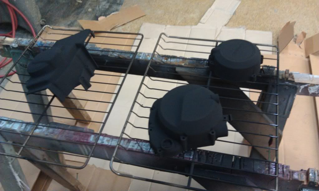

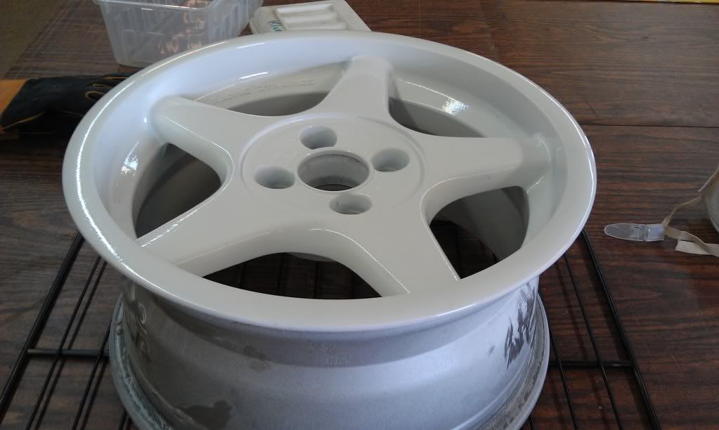

    Just wanting to show you guys what can be done with a $35 powder coating gun and a $40 oven.

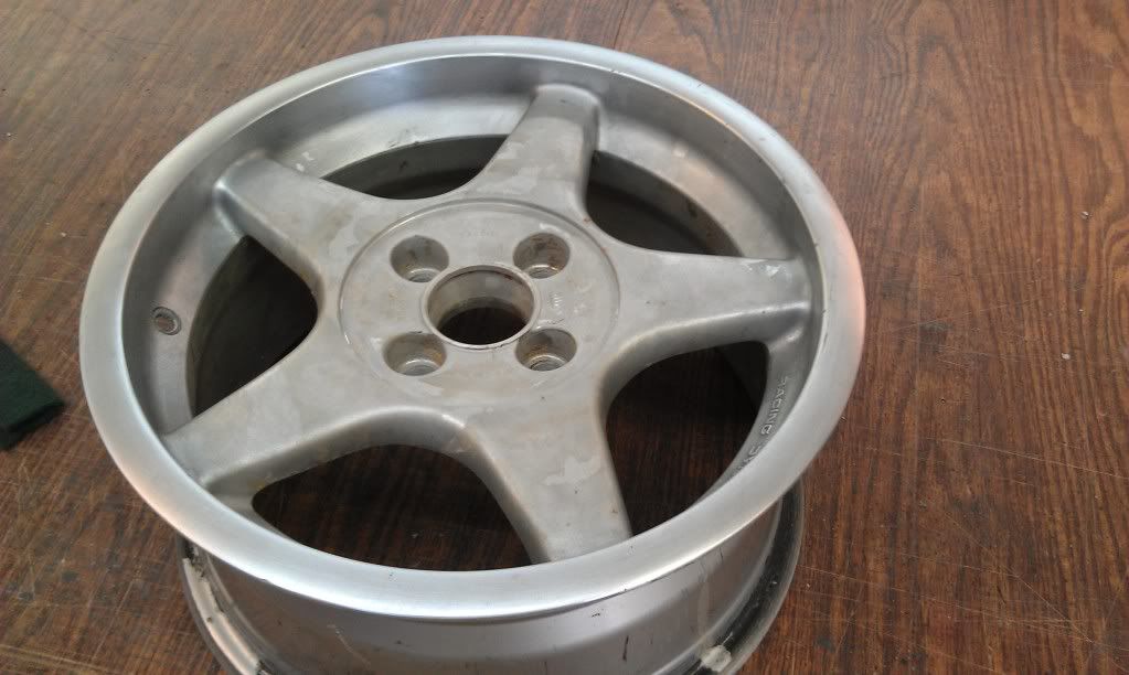

    Here are some engine covers I did for my motorcycle and some wheels I did for a friends e30 for the upcoming drift season. Sorry for the phone pics
    Wheels

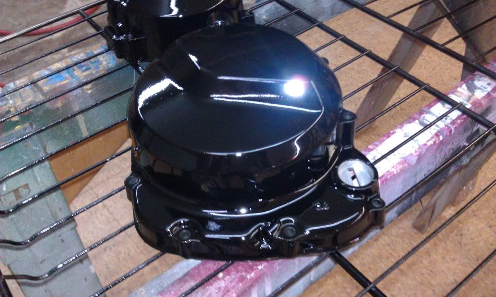

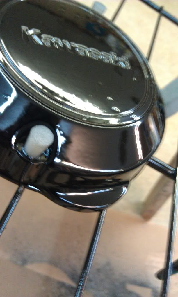

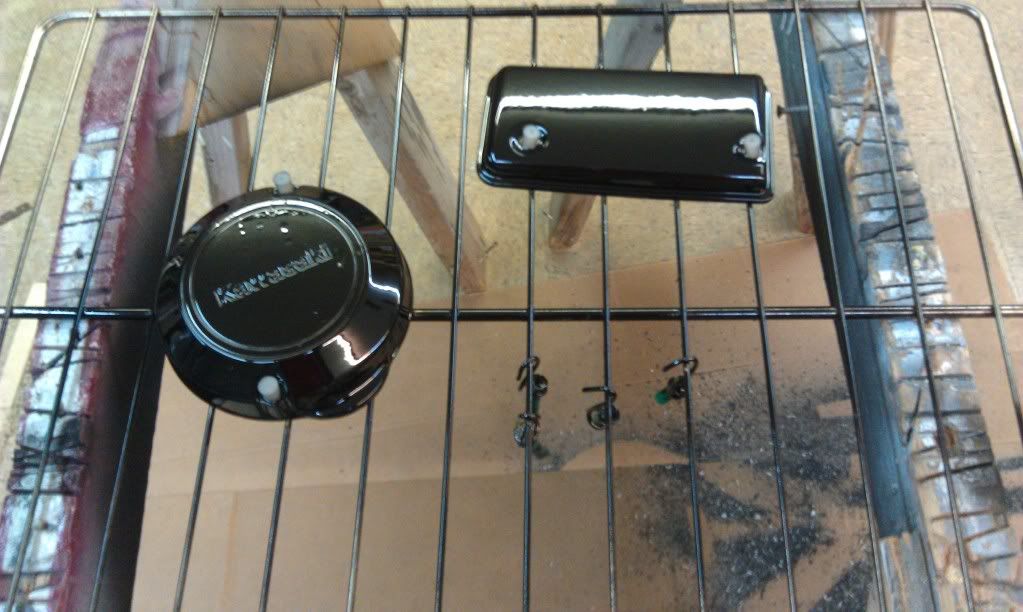

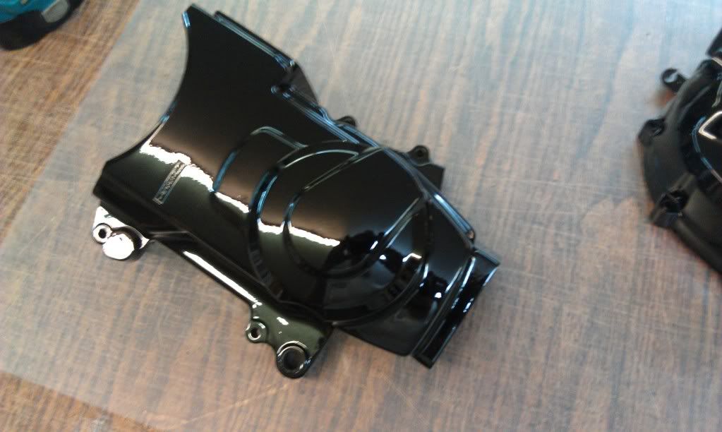

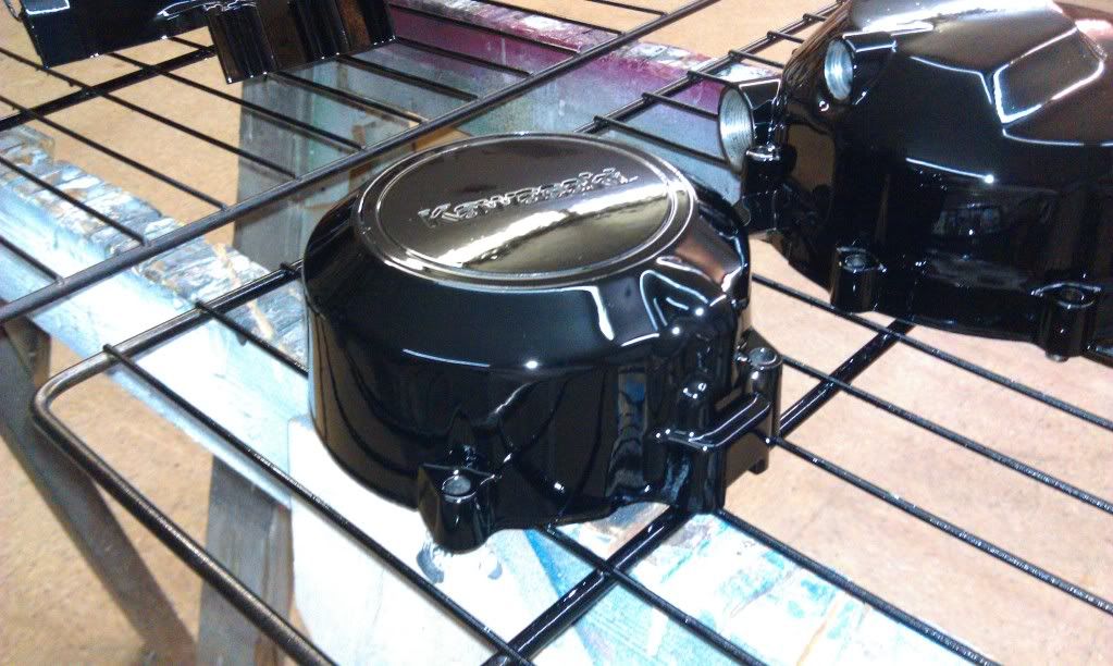

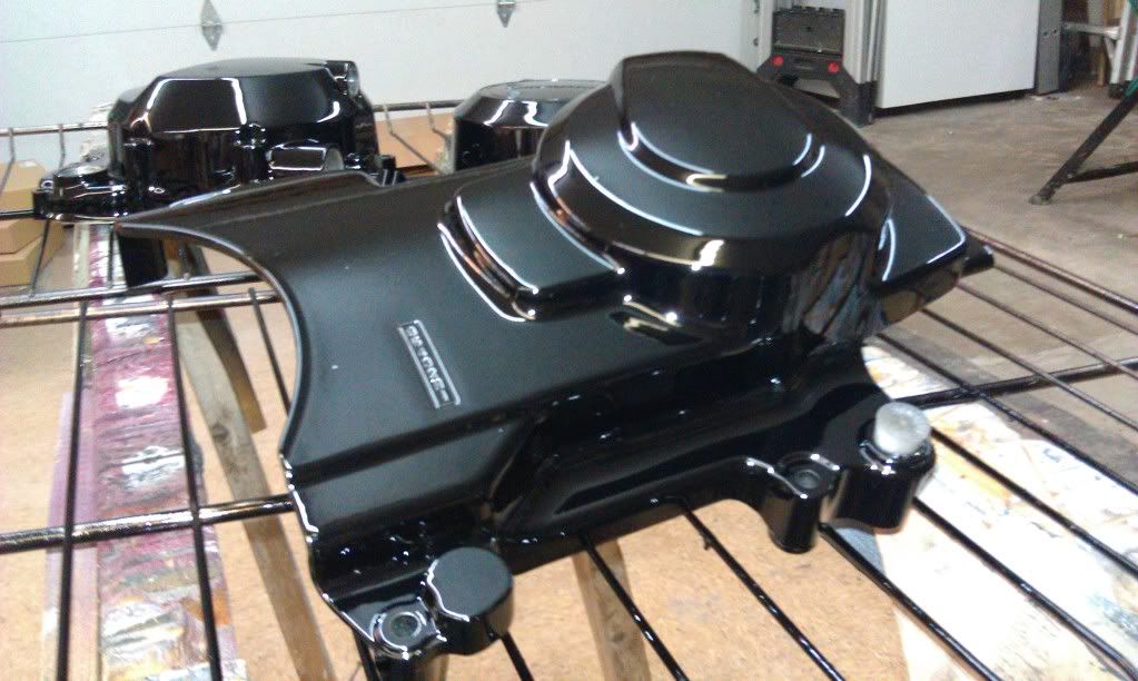

        The dips in the kawasaki cover were left because I am gonna cover that center part up with something, most likely aluminum. And you can see some trash in the clutch cover... its in the clear. I shouldn't have wasted my time clearing on top of that black because it didn't need it but I sanded and buffed all that out now. When I get the bike out in the summer I'll get some pictures of it all together.

            Did you off gas the engine parts first? Thats the most crucial part in doing a part that was previously exposed to oil
            www.gecoils.com
            • willworkfore30s
              • Aug 2011
              • 1090
              Yeah, for about 20 min at baking temp

                      Not as nice, but my friend did these at my place with a harbor freight gun and a toaster oven. With more prep and a bit more powder these would have been tits. Anyone can do this stuff at home. If you get a shity electric oven off C list you could even do some 15-16 wheels I bet.

                        the oven i got is about the biggest house oven you would normally find and i got 15's in there but I'm not sure the door would close with 16's
