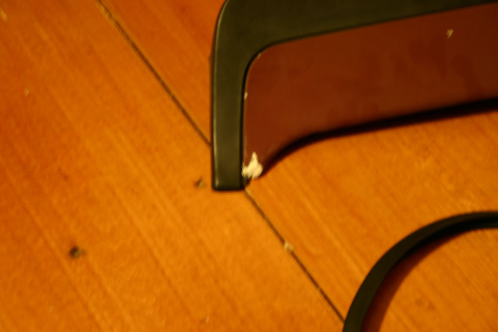

    In shipment, a bit of the center plastic/fiberglass section broke off. It's the last little bit where the center section meets the edge. Only about 1 cm broke off.
    If you guys know my luck with M-tech 1 spoilers, I am determined to repair this fault.
    What are some body shop type products that I can use to mold a new end to the section? It's not that much, and I'm not worried about it looking perfect.

        Now with pics.

          Buy a Bondo fiberglass kit from Home Depot or an autoparts store, you'll be fine with that.

              use a fiberglass kit and dremel to smooth it out afterwards.

                    If it is made out of fiberglass. use the duraglass, it is a fiberglass bondo,
