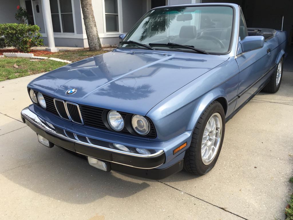

      End result
      Just a sample of mine after a polish.

        Has anybody actually tried this product from Classic Trim Coat? Does it work at all? Have not been able to find much info on real world results for this. Looks like a great product - if it works...
          http://classictrimcoat.com/bumper-stripping-kit.html
          Originally posted by agent
          If you sand the anodization off the bumper, it will require exponentially more cleaning and polishing once you do. The best solution I've found is the deoxidizer product from Classic Trimcoat. There should be some pics in my [first] build thread.

            You talking about Klaus? Yes, I read that, but could not really tell about the bumper. Looks good when you reinstalled it, but was it really oxidized or just really dirty? I couldn't tell in the pictures of it in the first posts. I have have found little info on results of their anodized bumper stripping kit... I've read where some say their product for the bumper surrounds works, some say it does not. Your results look pretty good...

              Both. Yeah, I didn't spend as much time on the bumpers as I could have. I'm not a fan of the chromed look that results when all the anodization is removed from the bumper and it gets mirror polished, so I used the same stuff as I used on the window trim pieces, and it's definitely an improvement though it's tough to see in the pics. They could stand to have a few more hours spent on them.
