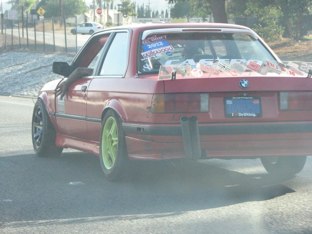

    Just do something like kman did
    I don't know how well it works you can ask him

      i know a guy, dan gurney, from All American Racers that has a wind tunnel that they use to make their carbon fiber kits and wings. maybe you could make an appointment to use the tunnel? They are located in Santa Ana, CA
