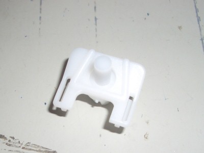

    My early model coupe didn't come with any of the door moldings. I bought a new set of moldings and brand new clips. There are 3 different styles of clips, and I bought a bunch of each to make sure I'm covered.
    I can't find any resource anywhere that shows which clips go where. Could anyone point me in the proper direction of which clips get installed in which holes?

      those ones go everywhere except first and last clips on all the molding.
      those should be your first clips for the door moulding piece (you only need 2 of these) and by first i mean if you count from the front of the car
      and then you should have the type that screws in. those go in the front of the fender moulding piece, and then in the end of the door and quarter panel moulding pieces.

        coupe doors take 3 of the first kind each, I think the quarters only need one each.

          Thanks guys, much appreciated. I know the back of the door and the back of the rear quarter are screw in. What about the front of the fender and the front of the rear quarter? Are those the big (first one pictured) kind, or the angled (second one pictured) kind?

            Front of the fender should be a screw in. The front of the quarter panel should be a normal one if im not mistaken. Just try if it fits. Honestly its not that big of a deal. Half of my moulding are just glued on silicone and they are hanging fine hehe
