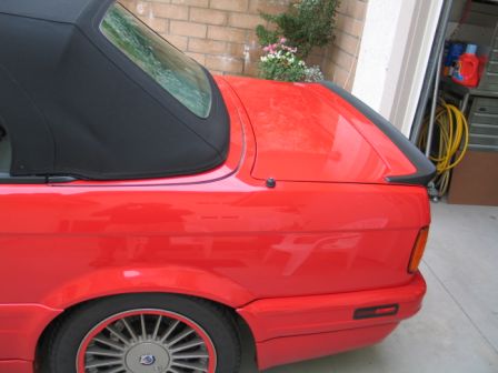

              M Tech 1 wing on a cabrio is right - but you need to get rid of the third tail light on the trunk deck. Two ways - 1) buy a coupe or sedan trunk deck (same part number as cabrio for the yr. of your car) - double check that part # interchange on realoem.com. If your lucky, you'll find one in good shape in your Blau color - if it had a is lip wing, even better as the mounting holes are the same for the M tech wing. 2) pull your brake light off the deck lid, fill holes, drill holes for the wing (find the template by searching this board & repaint. If your changing deck lids, be sure & do a test fit before you do anything.
              I just finished this project on my car. Have attached test fit photos - final photos will follow tomorrow.
              After having done this. one question remains - how do you wire the original 3rd light wires so the "brake light check" bulb will go off above the rear view mirror. Ryan, how did you do yours?
                  Cool - looking forward to the final pics! I'm leaning towards option 1 ...getting a new trunk lid. Since I have a few other parts that need painted, I might as well add a trunk lid to the list...would like to find one of an "IS" so the holes are already drilled from the factory.

                    Replacing the trunk is the best option. When you have your's painted to match, be sure & paint the plastic insert on the wing. The wing is two parts, the rubber. & the plastic piece that mounts to the rubber. This can easily be removed be the 3 small bolts on th bottom side. More than likely it is also held on wth 2 sided tape around its perimeter. Just take a putty knife & work your way around it carefully until it seperates from the rubber. Clean the old 2 sided tape off the rubber & plastic with 3M adhesive remover. When its ready to go back together, use new tape - then mount it - you'll be very please, it actually makes the car look longer.
