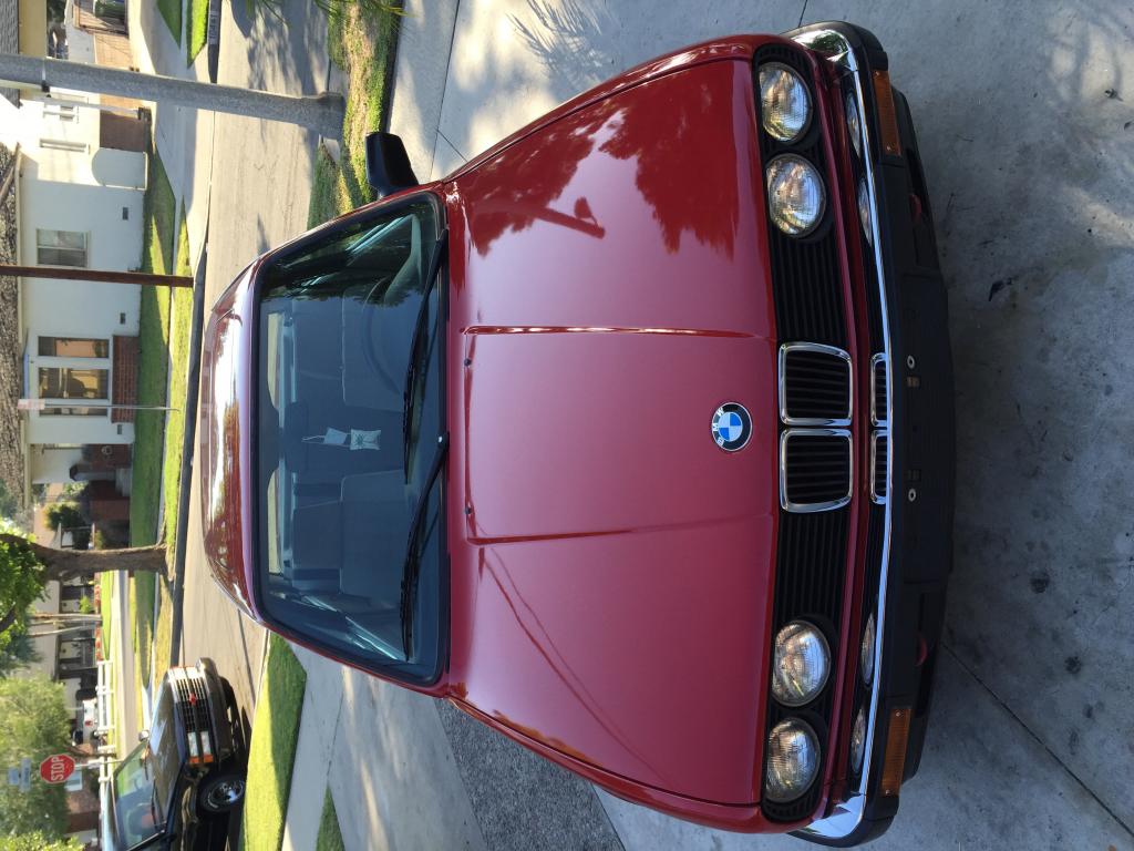

              85' bumper swap
              I was gonna do exactly what you're thinking of doing OP, putting plastic bumpers on my early model, but if you can source all the parts for a euro bumper swap it's much more satisfying imo. Definitely stands out amongst other e30s. Here's a picture of my car for reference

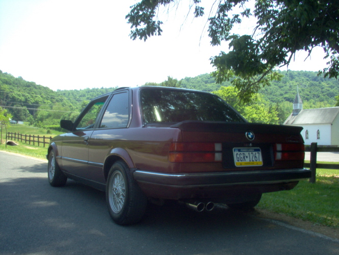

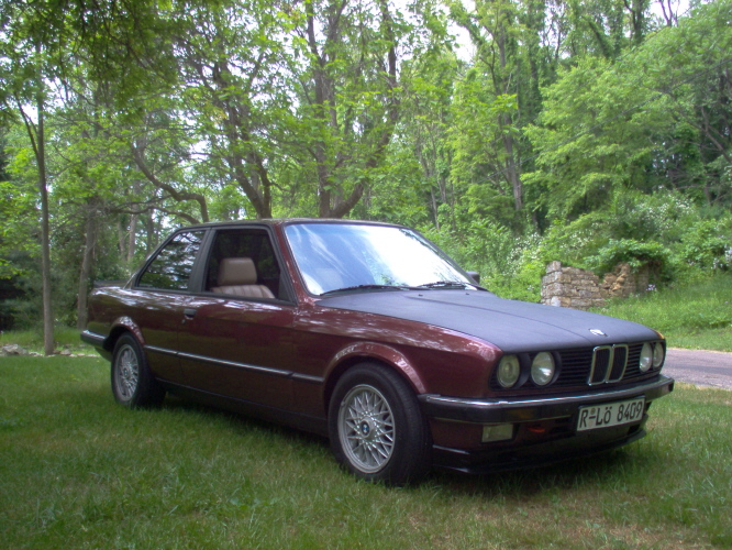

                      There's no such thing as a 1985 325I.
                      but anyways here's my 85 325e with euro bumper swap and also early euro valance.
                      And my 87 325es with plastic bumper swap (day I brought it home)
                      And the same car finished with euro bumpers and Zender front spoiler and rear apron.
