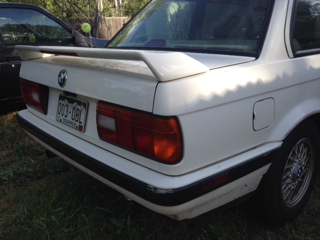

    I recently picked up a 318is. Not that familiar with e30s yet. Previous owner put on an aftermarket spoiler. I would prefer the OEM/stock (part# 51-71-1-945-710) version.

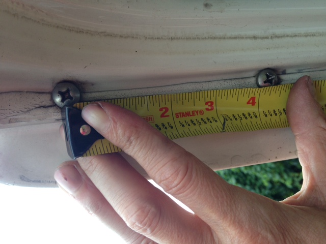

    It's mounted with screws that are drilled into the trunk/deck lid about 4 1/4 inches from each other (see attached photo). Is that the same distance as a genuine rear lip spoiler? I am hoping a genuine one mounts up using the same holes
    Thanks.

    nope, someone fucked up the rear deck lid on that 3 series with that m3 e30 rear spoiler
    with that drill job
    The rear is deck lid uses totally different holes
    good luck!

      Those 4 holes used for your current spoiler would be useless if you want to go OEM (part# 51-71-1-945-710) The OEM style spoiler you want will require you to drill 6 holes across the edge of the trunk lid.
      Refer to this thread for more info and pics.

        I figured as much but was hoping for a miracle. The things people do...
        Does anybody have a photo they can post of how the standard spoiler is mounted?
