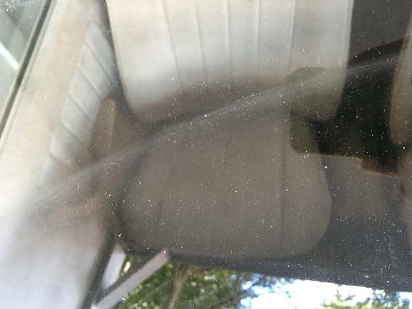

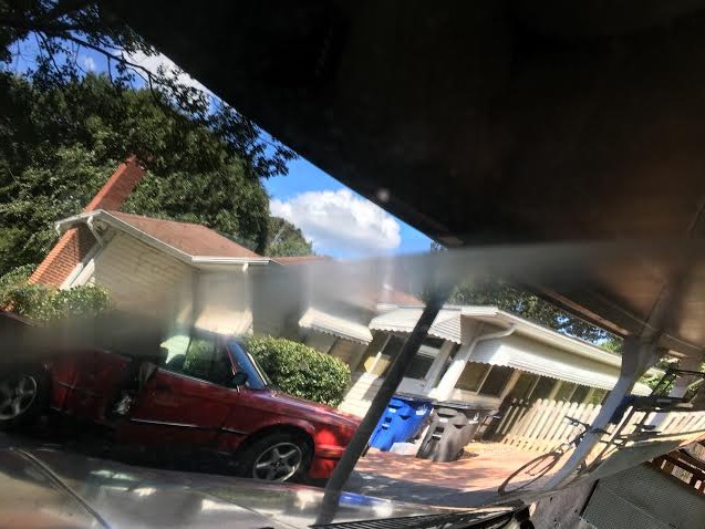

    My question is, as im cleaning 12 years of grime of this car, how do I treat issues with the windshield? There is a half moon streak from the wipers that windex and several baths with Meguiars arent removing.
    Any suggestions? My *new* baby thanks you.

    That sounds more like a scratch from the wiper arm sweeping with no wiper attached.

      old wipers. i assumed it was from worn out wipers having been used before the car was permanently parked in sun, rain. there are no scratches or unevenness but the streak is about 1-2" tall and has a kind of greyish haze.
      there is a different window - another streak - not scratch - that has no feel to the touch. looks white on the window. hoping to find something to clean both.
      good glass cleaner suggestions
      will try to post a pic tomorrow. :)

        Griot makes a glass polish. I've never used it and am sure they are not the only ones but it's worth a try
        Alice the Time Capsule
        • Mook613
          • Apr 2016
          • 232
          Glass polish is done with a suspended ceridium oxide based polish and a rayon pad on a rotary polisher (dual actions just don't have the power).
          It takes a long time and some knowledge to do it correctly.
          If there is a contaminant that can be removed then try using clay on your glass.
          If you could feel it then I'd recommend some good glass cleaner (such as Stoner's) and a razor blade with a long handle.

            Thanks. Tried a razor blade today. There is nothing to scrape. It looks like minute scratches but feels smooth to the touch. I will pick up some of the cleaners and give them a shot.

              I'd go with the polish and a polishing pad on a dual action or a rotary for that.
              • gath
                • 577
                You may also think if getting a new windshield is a better option, the prices are not very high depending on location. You may get one installed for maybe less than $150, which might be better than the hassle of trying to fix that if it is scratched.

                        Polishing glass is such an endeavor, rarely would it be cost effective. Even more so when speaking of an item as large as a windshield. Simply replace the glass if you want crysstal clear glass.
                        Then it will last for a few weeks.
