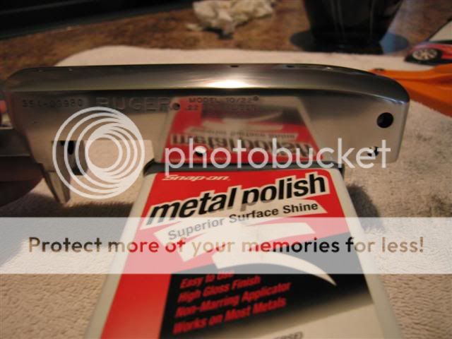

    So I'm a bit frustrated... I have been trying to get the art of metal polish down and it just simply isn't working. I'm going for a high reflection but I just keep getting scratches after using a microfiber. I would love any feedback on what to do. Im using my nardi wheel for test runs before I do my RS090 lips.
    My steps:
    Wet sand in steps and one direction starting at 800 grit, and then on to 1000. The wheel was in good condition before so I believed I didnt need to knock anything smooth with 400.
    Next I used a denim wheel on an angle grinder with tripoli rouge and rubbed the rouge in until no black came off any longer. I did that across the whole wheel in the same direction I sanded.
    Then I followed up with a cotton wheel with white polishing rouge and did the same thing.
    Then when i move onto using mag and aluminum polish with a clean microfiber, the wheel develops shallow scratches. Pictures provided show the scratches.

          when I was into polishing metal I used 2000 and 2500 grit, but I think the main problem I see is that you still have deep scratches from the lower grit sand papers visible. You need to be more patient and do a better job sanding before moving on to the next grit of sand paper. Re-sand everything and get those deep scratches out. Also, this stuff works better than anything else I've tried including mother's polish

              yah i think you want to keep going with the grits, 1200, 1500, 2000. and you have quite a few deep scratches there to get rid of by the looks of it.
              Although not quite the same, but when cutting back acrylic paint when spraying cars you don't get much shine below 1500, gotta get up to 2000 or even higher to get the mirror finishes with no visible scratches.

                Definitely higher grit. The purpose of using rougher grit is to break the level of metal down FASTER, but it creates more work in the long run because you'll need to magnify the time spent sanding on finer grit because you're sanding out the deeper marks from the previous grits. When I polish wheels I push with how ever much time I spent on the previous grit I double for the next grit up. This is where it gets time consuming and that's why there are still professionals still around. Add every step of grit all that way up to 2000.
                On a side note, those pictures are not true representations of the work. I believe the angle at which the photos were taken hide the imperfections. To truly see the work would be to make a much closer look with direct light reflection.
