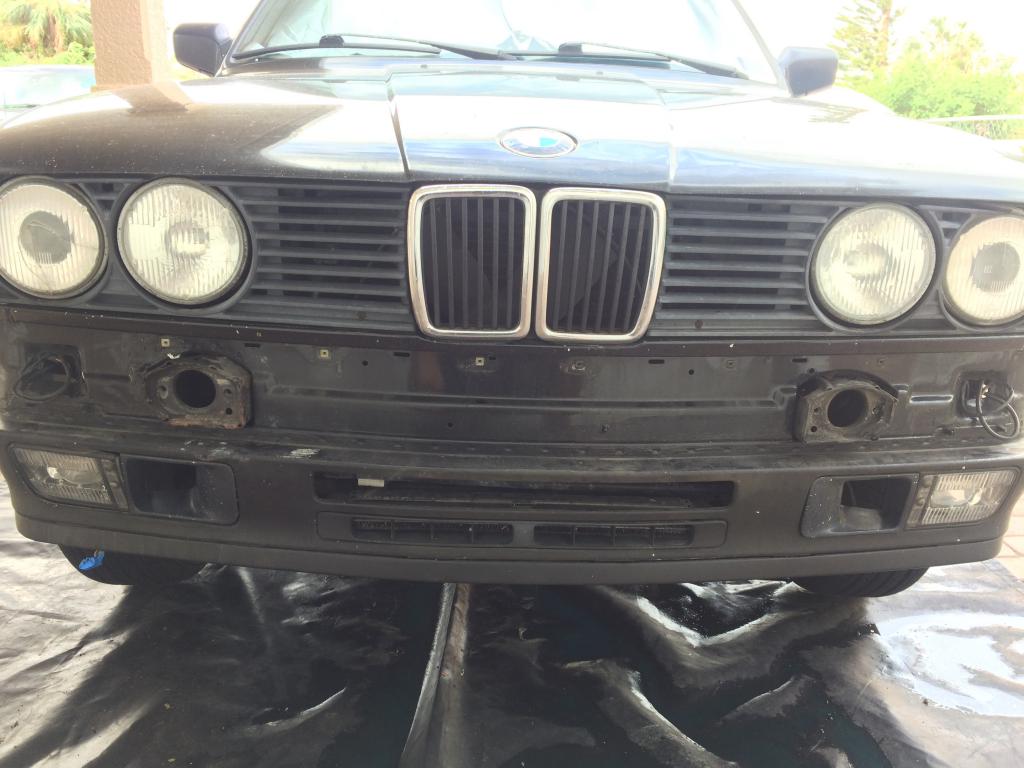

          So this where I am at. I removed the ugly chrome stuff with the trim.

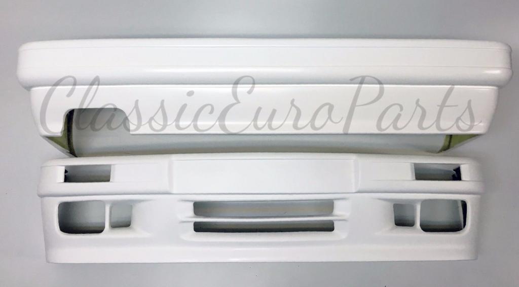

          And this is the ebay shit I bought.
          I don't want to get rid of the lower valance bc it has the integrated ducts sooo I guess I can't go mtech2. So what is the piece I need to fill in the upper section (where the chrome was)?

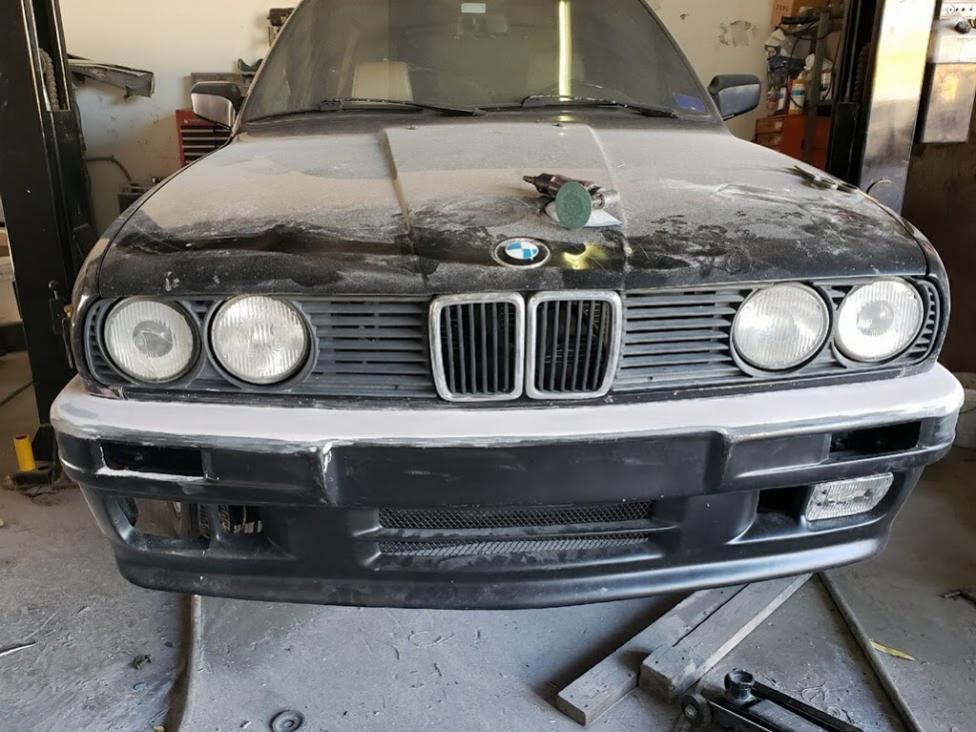

                        How it is so far:
                        Hopefully finishing soon...

                          quick question. how did you end up mounting the bumper? did you have the plastic carrier, or did you make something yourself?
                          • Zambuzan
                            • Nov 2017
                            • 434
                            My bodyshop guy just screwed in a thick piece of aluminum that stretches lengthwise from one frame rail to the other. So the bumper itself just slides into place. A bit ghetto but it works.
                            Fitment is decent, but don't expect perfection with eBay replica parts.
                            Also, you should know that the lower valence had to be cut off completely. Maybe this is standard, but thats just what had to be done in my case. Added some mounts behind the bumper to hold the fog lights.

                              Oh no...if you had gotten OEM M tech 2 parts, the spoiler would have just fit over the existing valance and you wouldn't have to cut anything.
