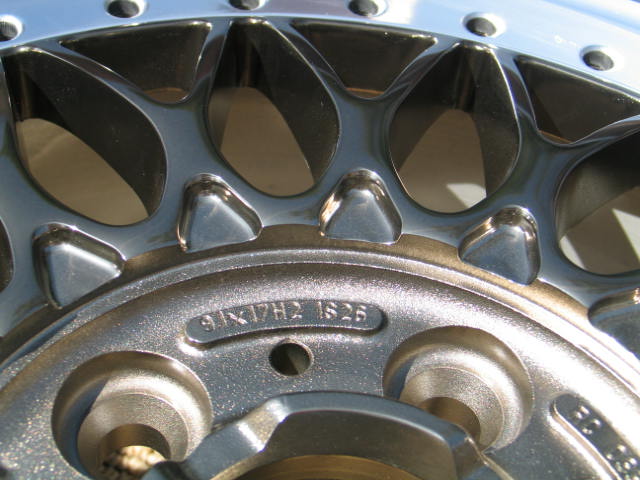

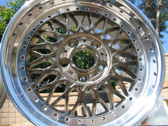

              • cactusjacks1
                • Sep 2004
                • 1216
                Originally posted by Court M3
                Got a set I want to get refinished, but can't find the color.
                Courtney,
                Just finished phase 1 of trying very hard to duplicate the look. BBS uses a 4 step process, this is a 4 step process using 2 different Cos. - 1) a wheel stripper/chrome 2) a wheel re-finisher for the final step. The pictures do not come close to doing the color/depth justice. Process still needs some minor tweaking.

                  • cactusjacks1
                    • Sep 2004
                    • 1216
                    that is what I'm looking for. What products did you use?
                    The first thing you need to find out is, if a metal refinisher or a powder coater (in your area) can do "micro fine ceramic clear coat" (spray NOT powdercoat). You might check local "jet hot" header shops. If not, you'll have to send them to me on the left coast to do the process. I'll help you all I can.
                    It might be less expensive to get the identical wheels here, do the process and ship them east.
                    Jack

                      • cactusjacks1
                        • Sep 2004
                        • 1216
                        Originally posted by VAPORBLADE
                        Many standard chroming shops will do it.
                        Very true on black chrome, but he is referring to "shadow chrome" - a very different color.
