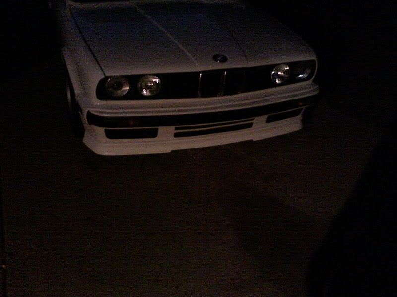

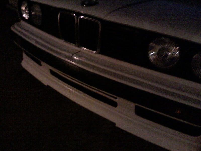

    740 lip on alpine white
    sorry for the night pics but i just got done and put it on. i think it looks good for $20. hell...my reiger lip cost 200 with shipping, and since ive lowered the vert, ive gotten a few cracks. the monthly bondo work was killing me. this is a great alternative for an affordable lip. hats off to CRIS for finding and sharing this.
    ill take some pics tomorrow

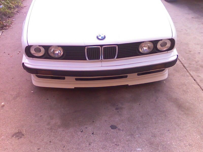

              looks really good....... How do you like it?
              Is the lip sticking out a bit- hard to tell with the pictures. Did you trim the part of the lip that connects to the valance (the part that screws on to the valance)????
              I forgot to mention that i trimmed a little bit off that piece about 1/8 of an inch - so it's vertically flush to the valance.
              But i think either way looks good.
              And thank you for the credit......much appreciated.

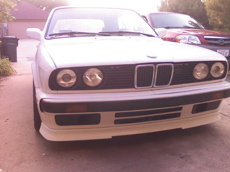

                no i didnt trim it. thought about it though. i think it looks fine. i need to re-trim the wheel well parts on the side a little more. no problem on the credit man, it was all you. thanks for sharin the info.
                kamotors- its from a volvo not 740i

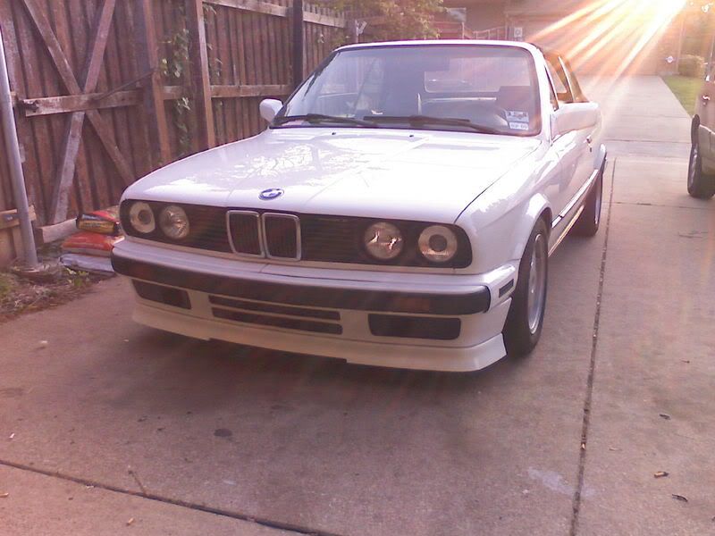

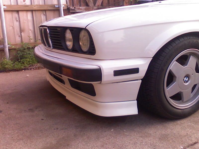

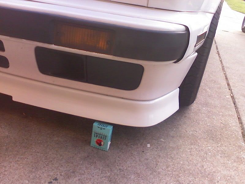

                  and one to show ground clearance, MUCH better than that damn reiger

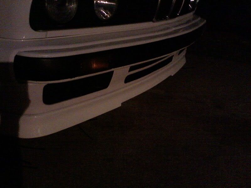

                    that looks awesome. this is offa old boxy 740 volvo? or one of those new ones with stock body kits? how much did it run you to pick it up?

                      Looks awesome! How did you mount it?

                        its off of the old boxy ones, its mounted upside down compared to how volvo mounts it. go to CRIS's thread just below mine "time to share"...
                        it was $20 bucks, but that yard raised its prices. CRIS got his for $12. so anywhere from 10 to 20 bucks plus paint. i trimmed the edges to sit flush with the wheel well and drilled 20 holes and zip tied it to the valence. if you take the iS lip clips off youll see the holes.
