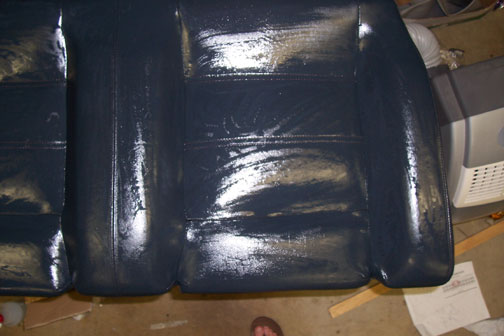

    The rear seat bottom in my vert is pretty dry and has shrunk up. I've seen worse looking vert seats, but still, this needed serious rehab. I've been reading a lot about Leatherique and started using it yesterday. It's just one day, but I've really been working it.
    Yesterday:
    1- cleaned with Prestine Clean (the co. misspelled "pristine"). Allowed to dry thoroughly.
    2- applied Rejuvenator, working in by hand. Applied Saran Wrap to reduce evaporation.
    Today:
    3- cleaned with Prestine Clean. Allow to dry.
    4- applied Rejuvenator liberally, wrapped with clear Home Depot painter's tarp, let sit in sun (it was 80 degrees here in OC) for about two hours.
    5- Lifted tarp, spritzed with filtered water to re-wet, work in, closed tarp. Let sit about two more hours, but in the shade.
    6- cleaned with Prestine Clean. Allow to dry.
    7- applied Rejuvenator, working it in by hand for about 30 minutes. let stand in shade, uncovered, about two hours.
    8-applied more Rejuvenator, working it in, let stand, went out to dinner.
    9- spritzed with water, wipe down with cloth.
    10- applied more Rejuvenator. Going to leave it overnight.

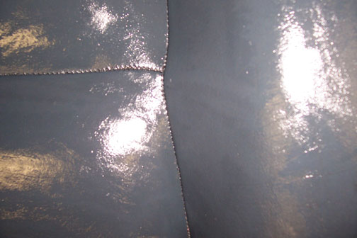

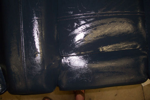

    The leather is a little softer, but things still look shrunken up. Check out the seams where the knee bolster meets the butt area and center bolster:
    The rear seat back was recovered by World Upholstery by the PO, so that's in great shape.
    Am I just wasting my time getting Popeye forearms? I was hoping that the leather would relax more than it has by now, considering how hard I've been working it in a 24 hour period.

    I've been doing some e30 leather projects recently and I've used quite a bit of leatherique rejuvinator oil and have some experience with it. The stuff does work well but only if it can actually get past the old 20 year old dye that is on your seat. See the original dye acts like a sealer and the rejuvinator oil is not able to penetrate through it so the oil just sits on the surface doing very little.
    Unfortunately, to see some benefit of the rejuvinator oil you need to at the very least lightly sand the old dye. You could start with around 800-1000 wet or dry Sandpaper or a Grey, Very Fine, scotch brite pad. If you do it light enough you won't hurt the finish and break through the color.
    So give the seat a very light sand, apply the oil and put saran wrap over it, then put it out in the sun. If you have hot direct sun then put a towel over the seat. You want it warm but not super burning hot. The heat helps open the pores in the leather and allows the oil to absorb better.
    I don't think you'll ever get the leather to "unshrink" but you may be able to get things soft and more plump.

    With that said, if you want to see a night and day difference in the softness of your hard leather then really what you have to do is remove as much of that shitty old lacquer based dye as you can and then re-dye your seats with some of Leatherique's water based dye. I've discovered that the old inflexible and brittle dye is the main reason why the leather feels hard and stiff. Once you remove some of the dye you won't believe how big of a difference that makes in the softness of the leather.
    To remove and soften the old dye use this prep solution, which I got from The Interior Guy. The solution is Isopropryl alcohol, TSP substitute, acetone, ammonia, and water, mixed in fifths in a spray bottle. This solution will soften, remove the old dye and prep the seats to accept new dye. Use this solution with 600grit sandpaper or a Grey Scotch Brite pad and wetsand the seats. Wear a respirator and rubber gloves.
    That may seem like some harsh chemicals but it works really well. I'll do a small writeup in the near future to show off my results.
    If you have a spare seat with bad leather then try this as a quick experiment: Put some acetone on a terry cloth and scrub the stiff leather. You should see the dye start to rub off and the leather should get noticeably softer.

      Your leather will never be as soft factory, or expand where it has shrunk. Just keep working with the oils, it will not happen overnight. Remember you are trying to rejuvenate 20+ year old leather that has been beaten by the sun. When the leather is compromised it starts dry out, hence the top dye cracks. It is hard to bring leather back to life no matter what you do. I would say just keep working with it but have patience. I sell a lot of water based dye products, I tell my customer to hit it with 400 grit wipe it off with mineral spirits and apply the dye.

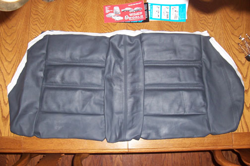

                      I got pissed trying to fight the stupid leather. Since the seatback leather had been replaced by World Upholstery, I called them to see what it cost for the seat bottom leather. At the time I hadn't planned on ordering it, but I'm impulsive and whipped out my Mastercard.
                      The package arrived yesterday and the leather looks great.
                      Looks like I'll stick with the original Indigo leather for a while. Honestly, I always liked the Alpine / Indigo cabrio combo. I'll just have to be diligent in minimizing sun exposure and treating the leather. While parking at my office I've been using the BMW rear window shade that clips on the exterior of the window. Anytime I'll be parked for a while I'll use it. So I've got lightly tinted windows, the BMW front and rear shades, that should be pretty good at keeping sun exposure to a minimum.
