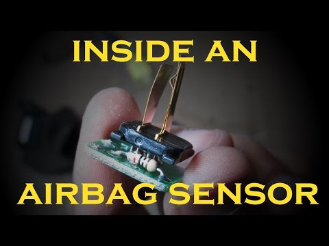

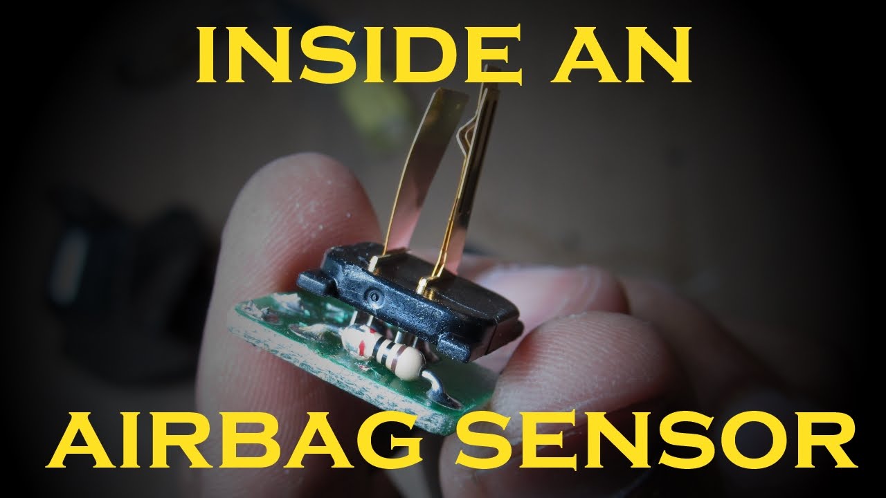

            The E30 crash sensor is available new 65771394113
            If you connect a sensor to an oscilloscope and then push it swiftly, shouldn't you see a spike if it works correctly?
            It seems a sensor has copper terminals and a pendulum that makes them contact during an impact.
            • Vincenze
              • Apr 2019
              • 1032
              If the terminals are covered with gold, they should be good for decades.
