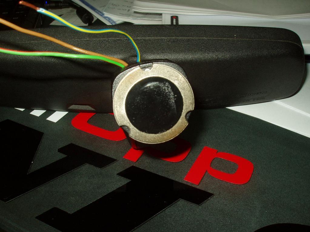

  • Erick
    replied
    Do you have to log in to access that file? Says not available.
    Leave a comment:
  • Spaz
    replied
    Hey Erick,
    Yeah i'd just suggest using the adhesive that comes in those kits and toss the plate,
    Check this out it shows how the mirror needs to be twisted on to the base plate try that to get it off. Then glue the old base back on, or if there is no base get a new one and glue it on with the windshield adhesive, wait a day and done!
    I've been wanting to retrofit one of those mirrors in my car as well, so we'll get it figured out!
    -cam

    Cam,
    I looked at the base plates they sell at the auto parts store. Those things suck. They are generic plastic pieces and from reading the boxes, they are designed to work with specific (although generic to domestic cars) mirrors that slide into the plate you attach to the windshield.
    All fine and dandy until you realize that the E38 mirror does not work with that at all.
    When I had an e38, I always toyed with the idea of retrofitting it's mirror to the e30, and I remember that BMW just glued the mirror straight to the windshield (exactly like the mirror on my e30 cabrio). Now, if they did it, then I don't need to convert this mirror to the shitty plastic US generic mirrors that they sell the kits for at the auto parts store.
    But here's the thing: If you look at my pictures (or any e38 mirror) you can tell that the mirror is two pieces at the very top, which looks to me like it's a base plate. I tried to twist that off, but I had no luck in doing so.
    If that little piece could be separated, then sticking it to the windshield would be cake.
    Thanks for the wiring tips though! That'll be very helpful!

  • Erick
    replied
    Pic 2
    Leave a comment:
  • Erick
    replied
    Pic 1
    Leave a comment:
  • Erick
    replied
    Hmm, I think I see what you're saying. The e38 mirror I have probably has both pieces attached. They are pretty tough to screw off each other.
    I'll take a pic. Any specific glue people suggest? I don't have much experience with any glue that adheres good to glass.
    - Erick
