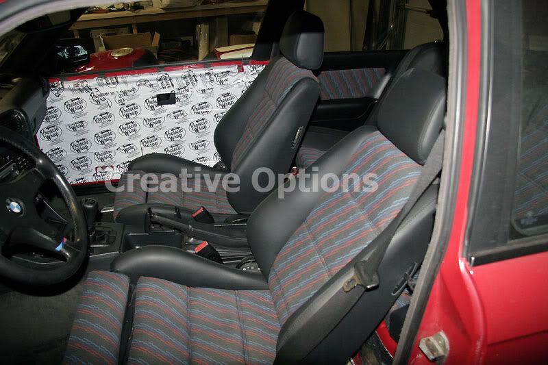

                        Thanks I did not do the the full black one but here is my version with mtech centers that my customer installed

                          ^Super nice interior. Love the panels. Can't wait as my car is the same exterior color.

                            He did a good job on the install as you did with yours. Your panels will look factory and hopefully you will have red seat belts..........
