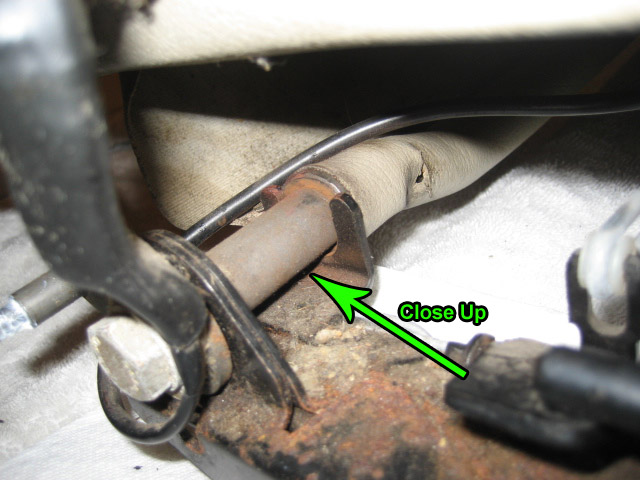

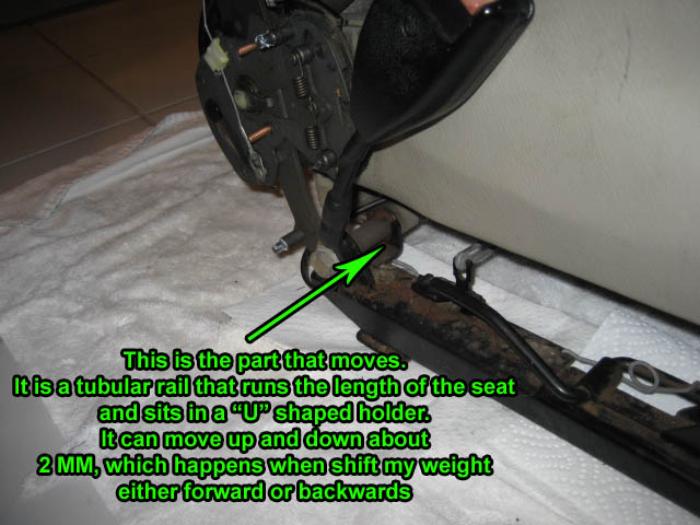

    So I am in the process of replacing the shocks on my seats. They are sport seats. While I have the seat out, I am also going to try to figure out what makes it loose, and I am hoping somebody can help.
    To begin, it was securely bolted into the car. The looseness isn't from that, I know that much. Furthermore, the motion is still there when the seat is simply on the floor. So I had my wife sit in the seat (which is presently in the middle of my kitchen) and I pushed the seat around and I saw where it is loose, but frankly I don't see how it can be fixed, and now I wonder if this is just how E30 seats are. I am, by the way, very new to the E30 universe.
    I have pictures below to hopefully help illustrate where the looseness is. Any ideas?

      you are missing spacers, there are thin metal washers that goes in there to hold them tightly in. usually 1 or 2 on each side. good pictures btw. easy to see whats going on.

            yes, home depot trip might work, though they are kind of like spring washers, push in and expand. But a regular washer might work.

                              DIY fix, not sure how long it will last but worked for me lol
                              check out the pics
                              i used a washer to fill in the gap . Installed seat and a lot more solid
                              Also found that one of the two rails had a lot of movement. I found that the loose rail was missing two small ball bearings see pic 2. I greased them and tapped them in with a small bar and hammer
