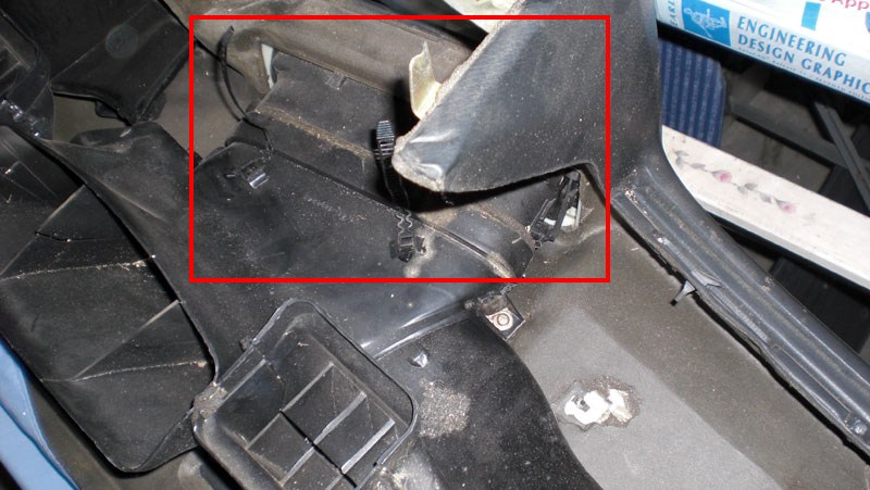

              Why is it you don't pull the whole dash?
              I just snapped you some pics. One moment please.
              Here ya go:

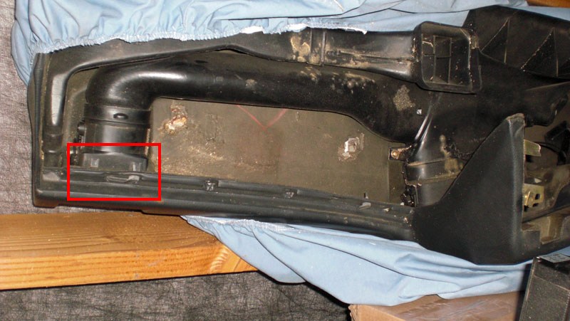

                Thanks george, your help is really appreciated, but I think I've been misunderstood - what I want to remove are the vents that you see in front of the dash, the ones that contain the vanes that will flop downwards on old cars.
                Edit to add: I know how to get the vanes out, but then I don't know how to get the surrounds out.
                As to removing the dash: how exciting is it, assuming that everything is out of it?
                Attached pictures for clarity.

                  Oh. Those are hard to get out, but you can. I believe you rotate down, and them rotate really hard till you hear a click. Then pull it out. It's been covered before. You'll need to search.

                        ^yea, now he's saying he wants the whole thing out - who know.... Undo the screws as shown in the pics.
                        I don't know man - I would think removing the dash is your best bet here. Good luck - you've confused me as to what you want.
