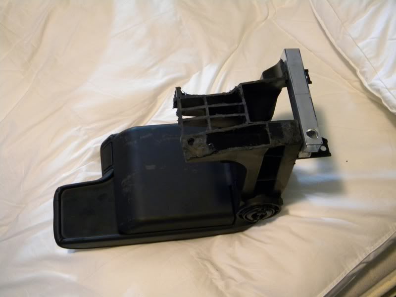

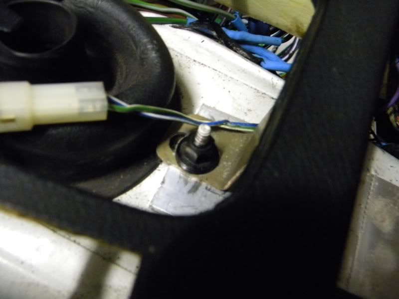

So here's what I have so far. It isn't actually mounted perse, but it's pretty much where it would be. Only reason it's like that is I'm in a delima. There's 3 ways I can go about fixing it.
The emergency brake release button is a little close to the console. Possible solutions:
1. Chop off about .5 in from the front of the E46 console to clear the emergency brake
-Disadvantages:E46 console would require repainting and plastic dip doesn't come in tan if it were to be a tan or even a grey one.
2. Trim the rear of the E30 console about .5 in.
-Disadvantages: May look weird, gotta play with photoshop a bit
3. Cut a slot into the E30 console that the front of the E46 console slides into.
-Disadvantages: may look weird and a little bit more fiberglassing work for me
4. Somehow shorten the emergency brake
-Disadvantages: Dunno how it's done and it may affect function.

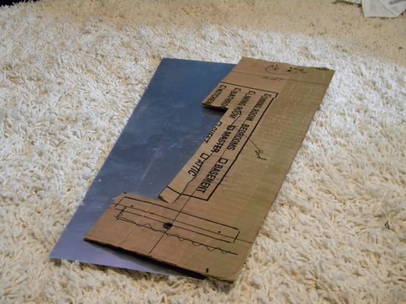

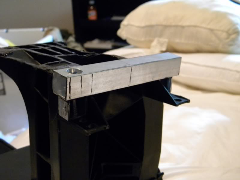

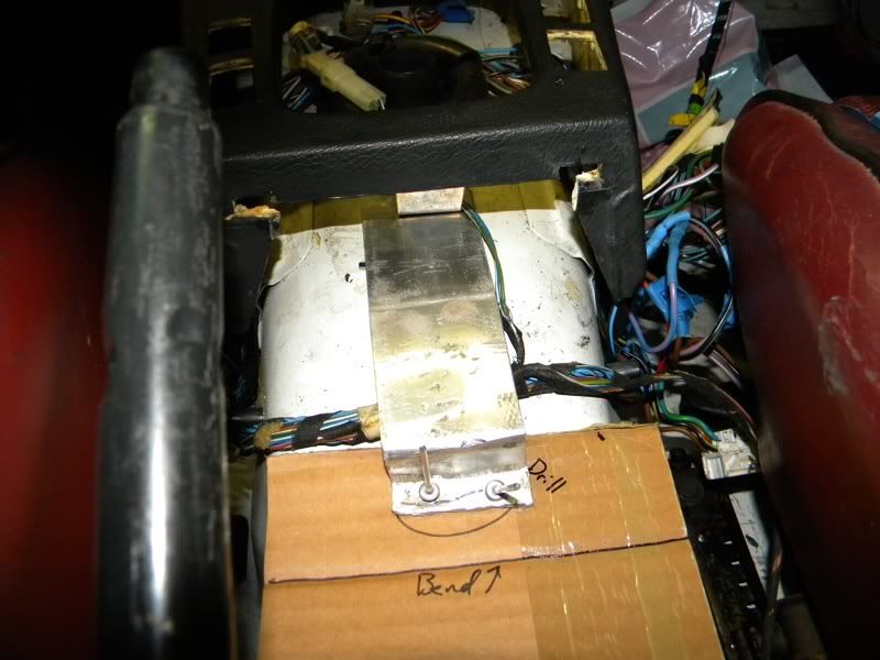

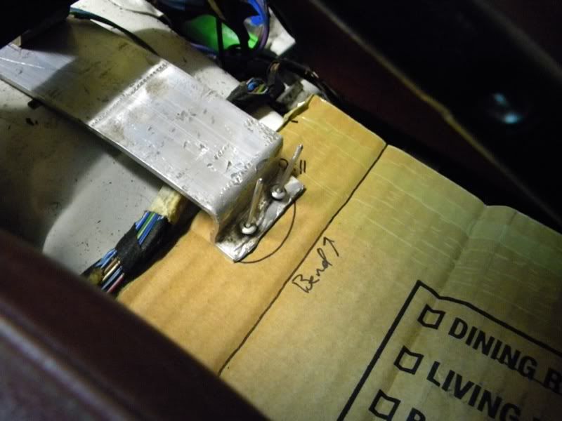

The mounts*:
The idea with it being mounted in the car is to use the factory studs so no holes will need to be drilled. I still have to do some testing to see if they will actually be enough. If not, you can always drill some holes.....
*Missing the side support bar as my tools crapped out and I don't a replacement that can cut aluminum. ;)

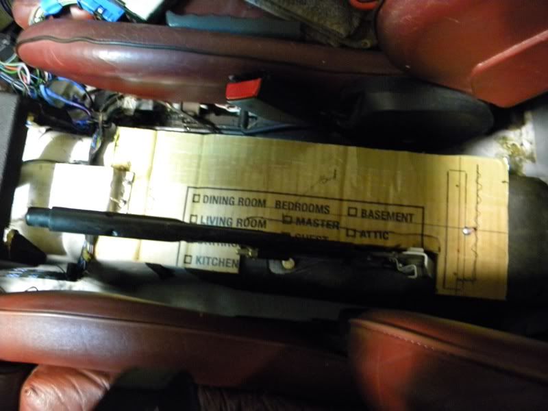

The cardboard's replacement:
I just cut a .5"-1" piece out of the ebrake handle. The button just unscrews. Then you can cut the handle an the rod inside it. After that I rethreaded the rod and the button screws back on. I still have to weld the handle back together, but it works perfectly.
I JB Welded it to test it and it actually held up to me really ripping up the handle, but for peace of mind I'm going to weld it.Matt
