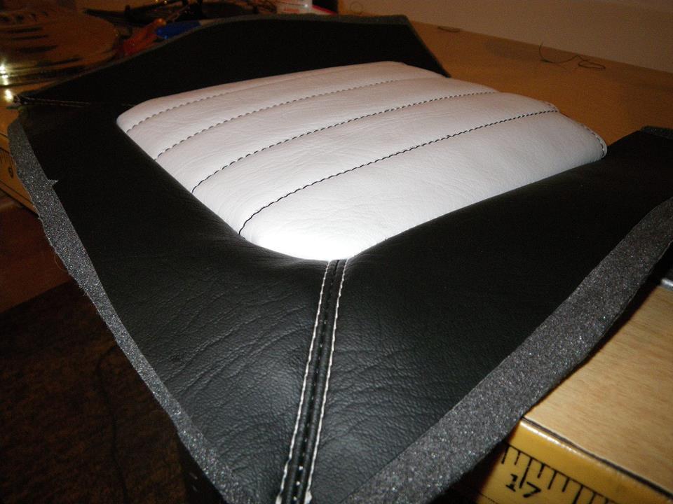

                  My first attempt
                  picked up my e30 about a month ago for $750 at an auction. mechanically it was in pretty good shape but the upholstery was a gleaming deficiency so I went ahead a started redoing it. this is my first attempt at upholstery, although I know my way around a sewing machine.
                  I used vinyl from a discount "end of the roll" type place in phoenix called SAS fabrics and got about 6 yards for less than $30. I'm sure it's not the best quality and will probably not weather all that well, but the price is right and it's a first attempt anyway so if it can't handle the temps then I will just redo it again.
                  I really like the diamond pattern so i thought i would try that. I think the first chair turned out pretty good. I had it all done once and thought it looked crappy so i pulled it apart, second try was alot better.
                  Oh, btw, people will tell you that you need an industrial walking foot machine, these cost into the thousands. I did this all with a "europro shark". Just a standard machine, used a heavy duty/leather needle, fabric store nylon upholstery thread with machine set on high tension (6.5-7) and the longest stitch length my machine will do which is 4.5 mm. I reinforced all my seams with backstitches at the beginning and end and went over most of the seams twice.
                  I will post more picks when I get everything done and reinstalled. I'm also doing my dash at the same time so may be a while.
                  Oh by the way... does anyone have any experience with auto carpet dye? good? bad? ugly? thinking of going from grey to black.

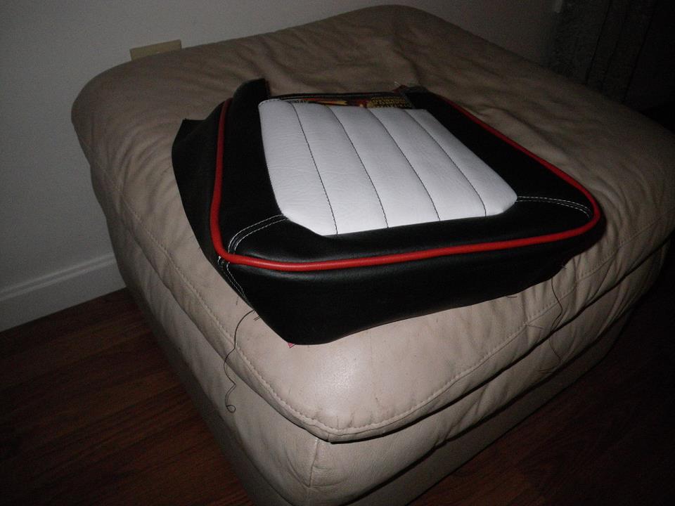

                            oh here's a little teaser, my dad's starting on upholstery for his 81 camaro z28. This is his first attempt and he did a really damn good job so far.

                              #59
                              Update

                                Whiteclef, I like the diamond pattern a lot, I was thinking of something similar, but never had the time to try it out. Your patterning looks good. I agree with your statement about the industrial walking foot machine not being a necessity, but just as you can splice wires with out a soldering iron, You can use a regular machine. I used one for my first seat as well, but it makes it so much easier to work with any material or leather. You can get a good used walking foot machine for about $500, do one job and it's paid for. Just how I feel, but I can't wait to see the rest of the interior when it's done, what's the plan for the door cards?
