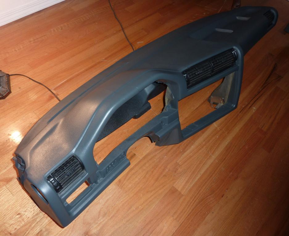

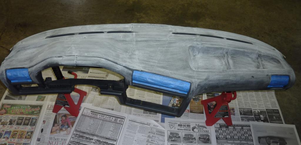

SEM tends to set the standard. I just did my dash and iit came out pretty well considering how much I invested ($4 for black caulking, $14 for the SEM color dye rattlecan, and $18 for the SEM spray texture. It's not perfect, and the SEM Graphite color is a hair lighter than OEM. But it really beats a super cracked dash like I had. Process is prep prep prep . . . to get rid of any oils and silicons. Then multiple LIGHT coats. When using vinyl dyes, the idea of one coat coverage should be out of your vocabulary. The dye soaks into the vinyl, and lighter coats soak in better.Comment
^ that looks great. but damn you pulled your dash all out just for that?!Originally posted by blunttechr3v does not fuck around. First you get banned, then they shoot youComment
Looks alot more appealing since it is way cheaper to do than buying another dash. It looks more gray though. I thought the dashes were black?????
