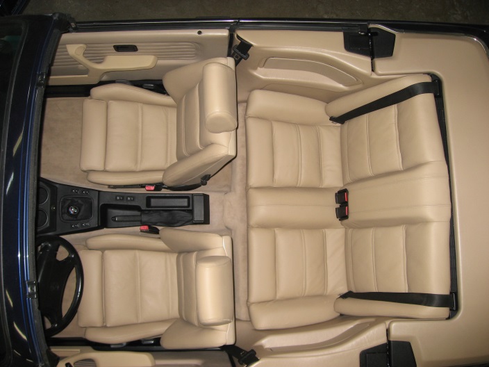

I don't have the money to buy a new seats that are heated but is there anyway to take a normal seat and add heated seat pads and buttons for them in a convertible?
heated seat conversion?
Yup. Many kits out there. I used this company for my two front leather Recaros. You have to take the seat apart which is probable the hardest part.

I bought a heated seat kit from the BMW dealer but that was several years ago. Don't know if they are still available but if so, it looks completely stock (because it is!)

I think it was about $350 back then but I could be off as it has been quite a while. I remember it wasn't cheap but it has worked very, very well and I like the factory look.

Here you can see a picture of the switches. They light up when turned on.
As mentioned in other posts though, you have to take the seats apart to install the heating element. I wasn't that brave and had an upholstery shop do it.
