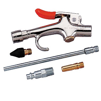

    I have been researching the process. An electrostatic gun is preferred to get all the flock to stand in uniform. This is a spendy piece of equipment and I am not up to the task of building one. I am really interested in the air-gun + can applicators.
    http://www.donjer.com sells a can and an air-gun for this purpose. However I was looking at the can, and I don't understand why I couldn't just buy the can and fit it to my existing air gun? Here are pics of each.
    Donjer Flock Can:
    typical air-gun:
    It seems like I could just buy the applicator can, the flock and the adhesive (everyone on the woodworking sites recommends rustoleum oil based adhesives), and then cobble together a blast cabinet like this guy did.

                          So I was able to build my own flocking gun. Donjer sells one for $70 bucks! I already had a $12 craftsman air-gun. So I spent $7.50 on a Donjer replacement can and $1.65 on some fittings and made my own.
                          I had to drill a hole in the cap.
                          Here are pics of the part numbers if anyone wants to replicate this:
