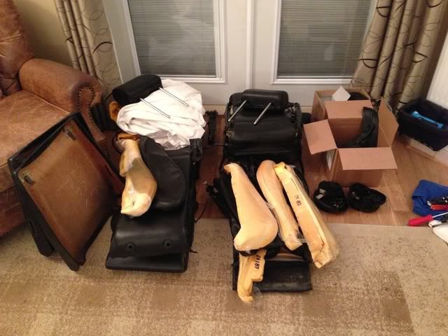

              I'm in the middle of doing this right now, after some investigation into the seat designs it is infact, not possible to just straight swap the upholstered portions from frame to frame without a little... extra work. This is what it came to for swapping them on mine (plus a tiny bit more because I'm going to end up getting new upholstery cut/stitched before install as well as new heaters). The metal frames are not interchangeable, so you end up needing to cut the hog rings on all the leather and swapping them over to the other sides. It is not a 5 minute job, but it is not hard to do just time consuming.

                The only difference in the leather is the holes for the release levers.
