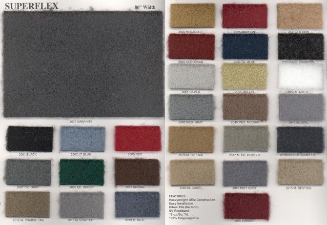

                              Has anyone looked into the correct anthracite carpet for the shelf ? Ozite carpet or Superflex ( if they are not one and the same ) seems to be the way to go.
                              Looking at this sample chart , 2078 Special Graphite looks good, or 2070 Graphite.
                              I can't find this carpet in the UK , so want to be sure before possibly ordering from the US. So far no one will ship even a sample card, let alone 2 yards of the carpet.
