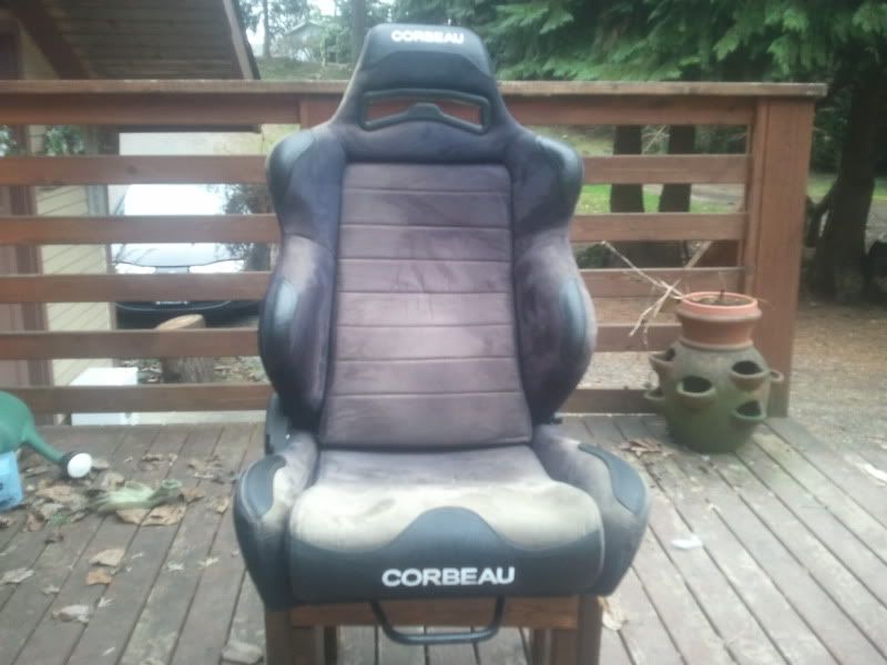

              I have the same problem. .. I am a 40-42 waist ... I ended up buying a set of these corbeau that are the XL
              They fit but u sacrifice leg room for being wider as it cannot move back a whole lot (it moves but is wedged against the center console.)
              There are a lot of seats now in XL form like the sparco XL. ...
              Good luck. ... I ended up buying old recaros that are fully adjustable. ..
