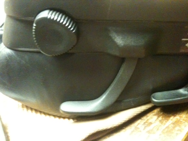

    Neither, and no one else that I have found, tackles the seat base tilt that activates with the middle control on the side of the base (the lever fully in the picture).

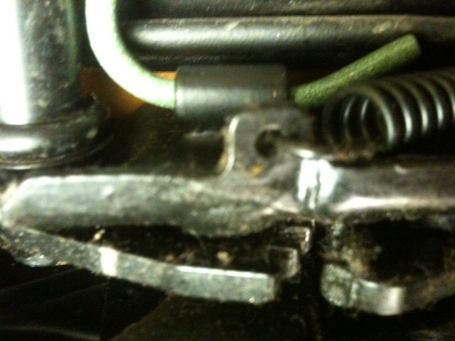

    There appear to be a set of ratcheting teeth on the bottom of the seat base by the front cross-member that move when the lever is pushed.
    Anybody had a go at that? Help much appreciated...

    or locking?
    dunno...
    astiv43
    '89 Zinoberrot 325i 'vert, auto
    • astiv43
      • Oct 2011
      • 21
      locking, as it turns out

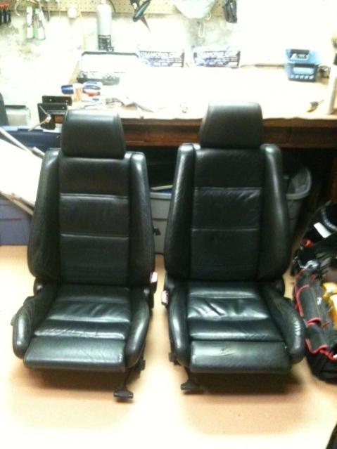

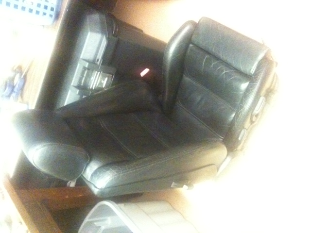

      just needed a little wd-40 and exercise. Wiped it down, added some more appropriate lube, and all back together With all functions working perfectly. Leather is a bit cracked, but I'll leave re-upholstery for another time. The finished product, waiting for me to get some anti-seize for the floor bolts:

        And done: lots of lube and one L-bracket weld later.
