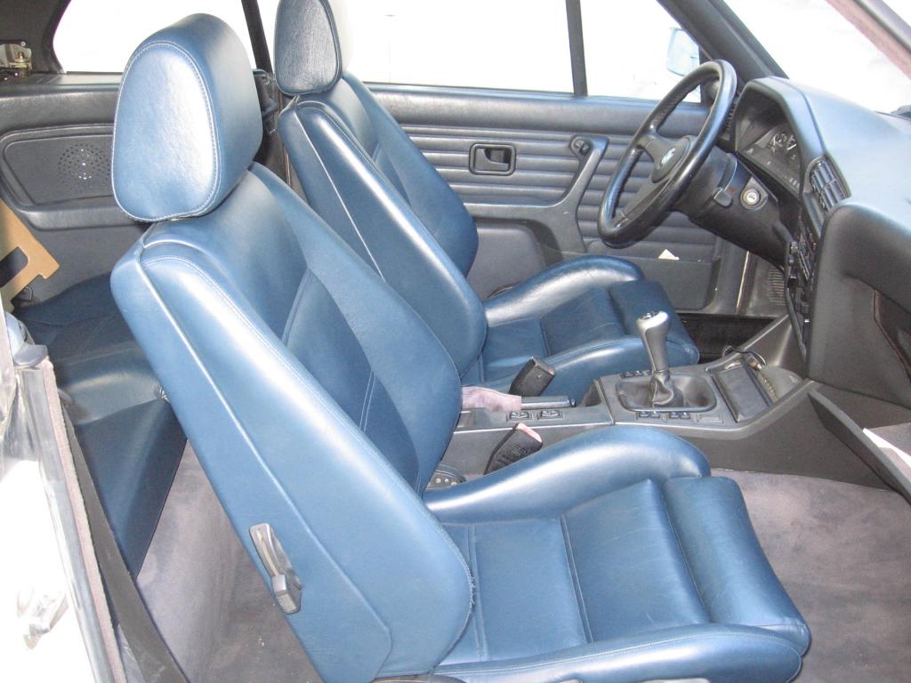

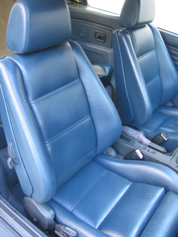

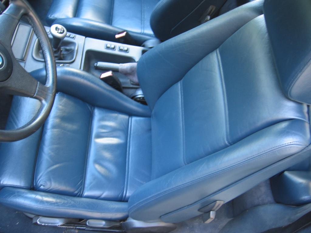

                  Well here is the passenger side. I think it turned out better then the drivers side. I had to shoot a 3rd or 4th coat on because my air/paint mix wasn't adjusted properly and got a rough finish. So I went at it again with more product coming out of the gun and increased the air pressure and got it to the texture I wanted.
                  • sector6
                    • 909
                    nice job! looks great!
