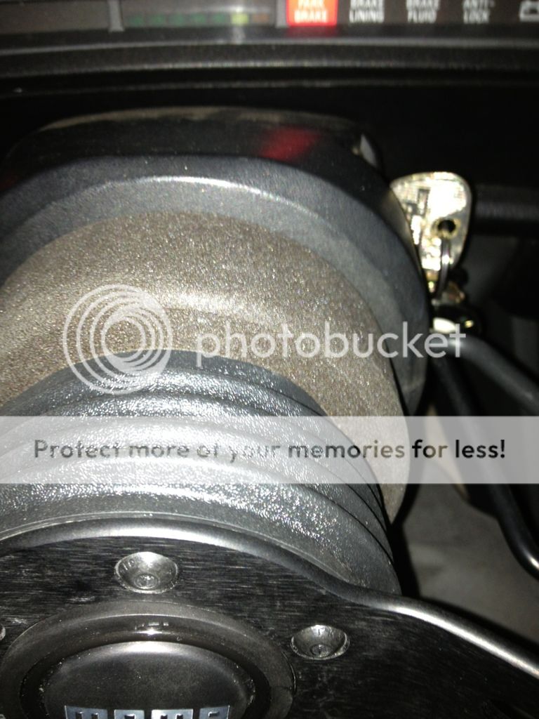

Does momo make a hub that fits a airbag car?
  • MR 325
    • 37832
    You only need ONE of those thick spacers behind the wheel, the other goes on AFTER the hub is mounted as Barry mentioned. You also need to take that white plastic nub out that's shown in your second pic. Pull it straight out with a set of pliers.

      that white pawl in the upper left of picture #2 needs to be removed as well IIRC

      so if you didnt get it like that did you glue fuzzy oil to the entire thing?
      • bmwstephen
        • 2463
        this. grab with pliers and yank it out

          Thanks! got it installed and looking good
          • IRON-E
            • 16548
            You're welcome dude, I knew it was something simple. I have been in this position before, hence the reason why I asked to remove the wheel and show us what you had.
            I'm glad the community came to the rescue. ;)
