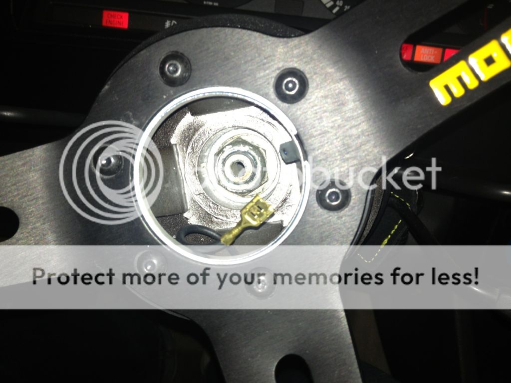

              Not sure of the part number because I bought it second hand. heres what it looks like installed:

                      • K1CKBAC
                        • Oct 2011
                        • 306
                        What is that silver block..

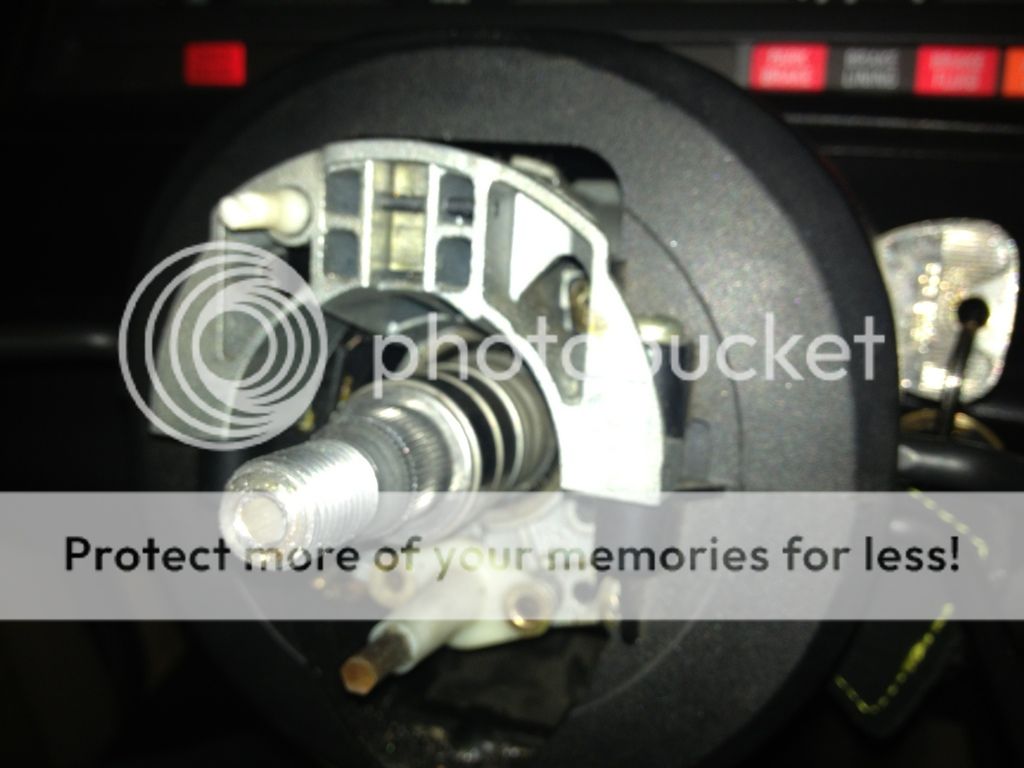

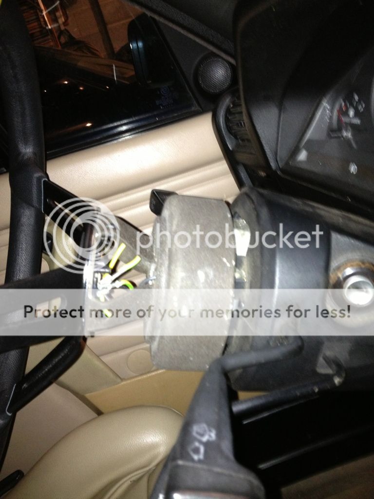

                          More pictures dude, take off the hub and show us the bare steering column top.
                          I've never had any issues, with MOMO hubs either, that is just strange..
                          @IRON-E30 aka Edwin:D
                          • Brezzi
                            • Jan 2010
                            • 1630

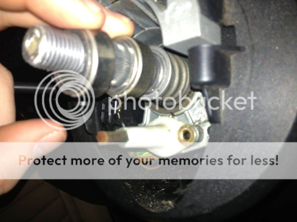

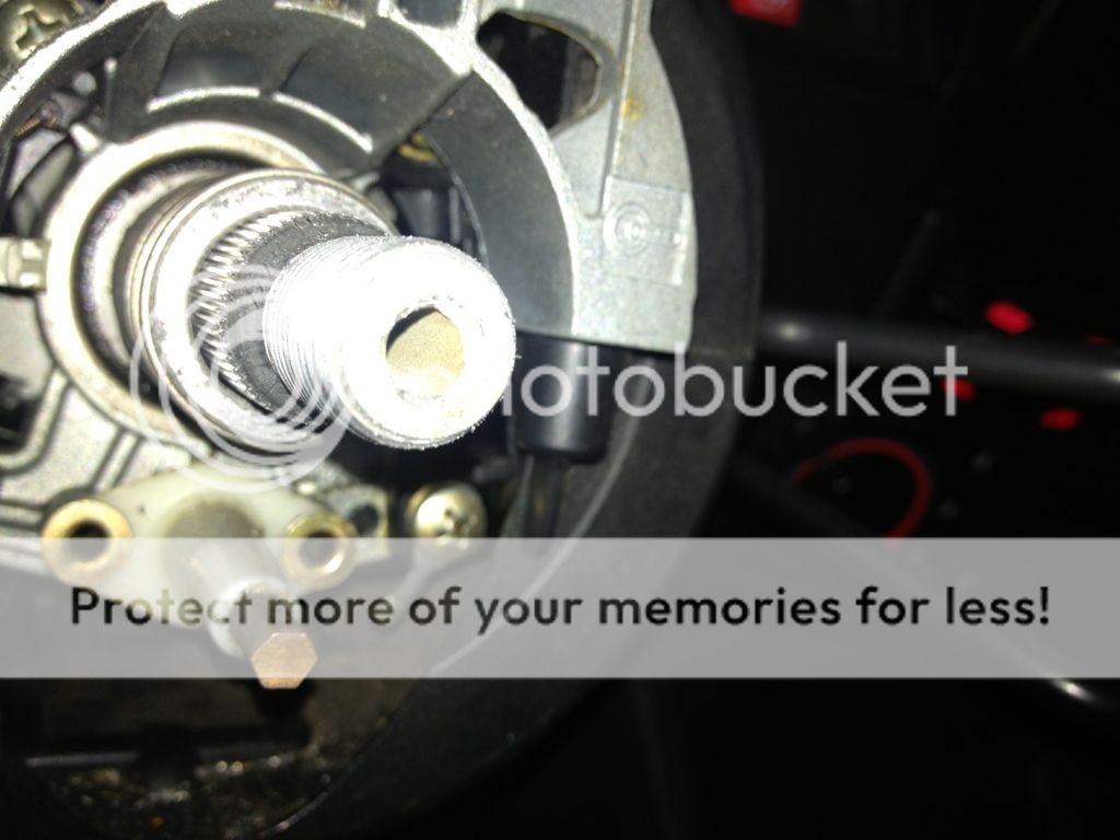

                            I took some pics, came out kinda shitty. I'll try and get some with a camera later.
                            • reelizmpro
                              • 9543
                              spacers are on the wrong side? when installing a wheel on an airbag car the spacers go on the outside right behind the nut/washer to take up the extra space.
