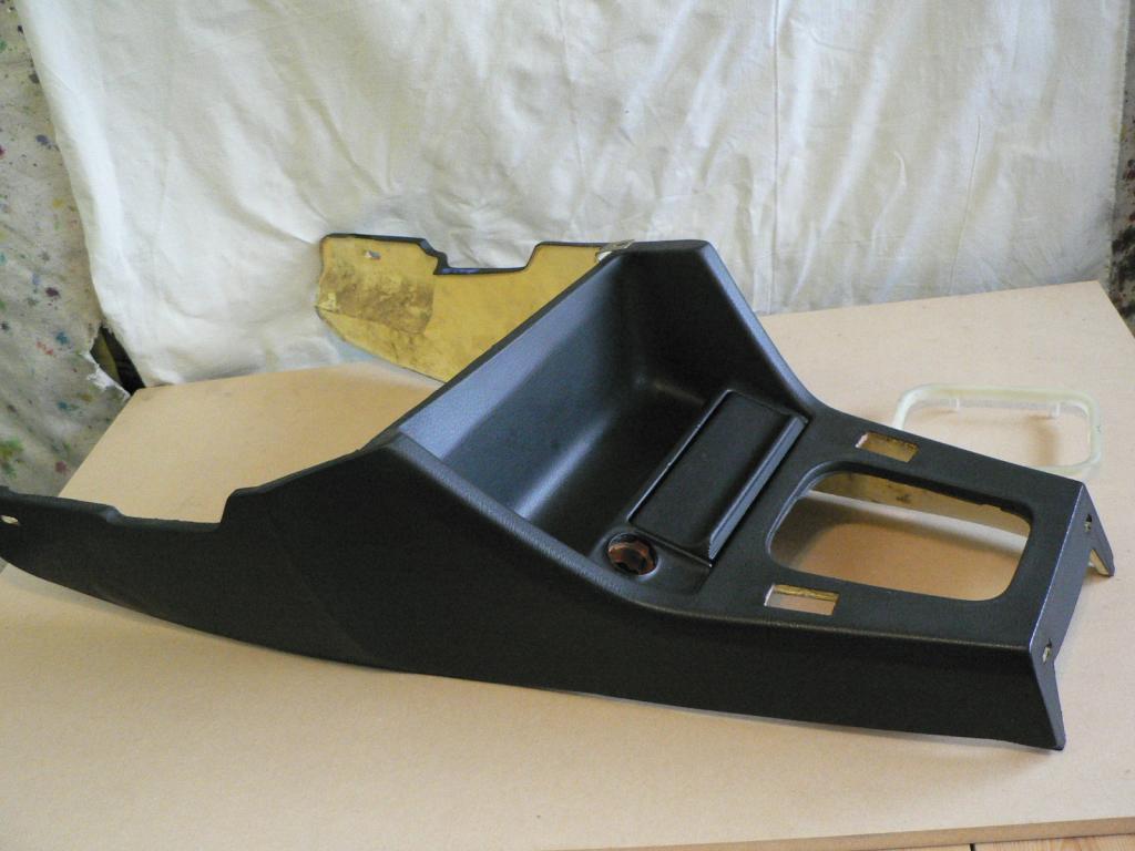

    Can you guys chime in on this? fitment issue.
    I have this two button partition -
    but is doesnt fit in my 318is, not to mention, I need a three button cuz of breaker, the part # from OEM for my VIN is #51161941830.
    The real question is what makes this partition not fit? Are there different part #'s for three button vs two button, auto vs std
    Can someone identify what storing partition is correct?

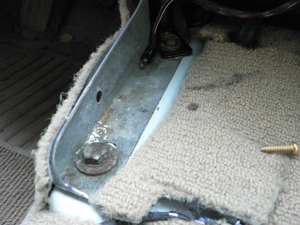

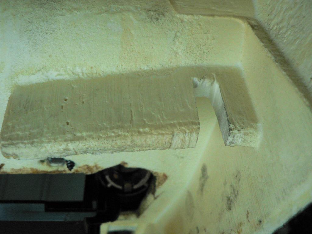

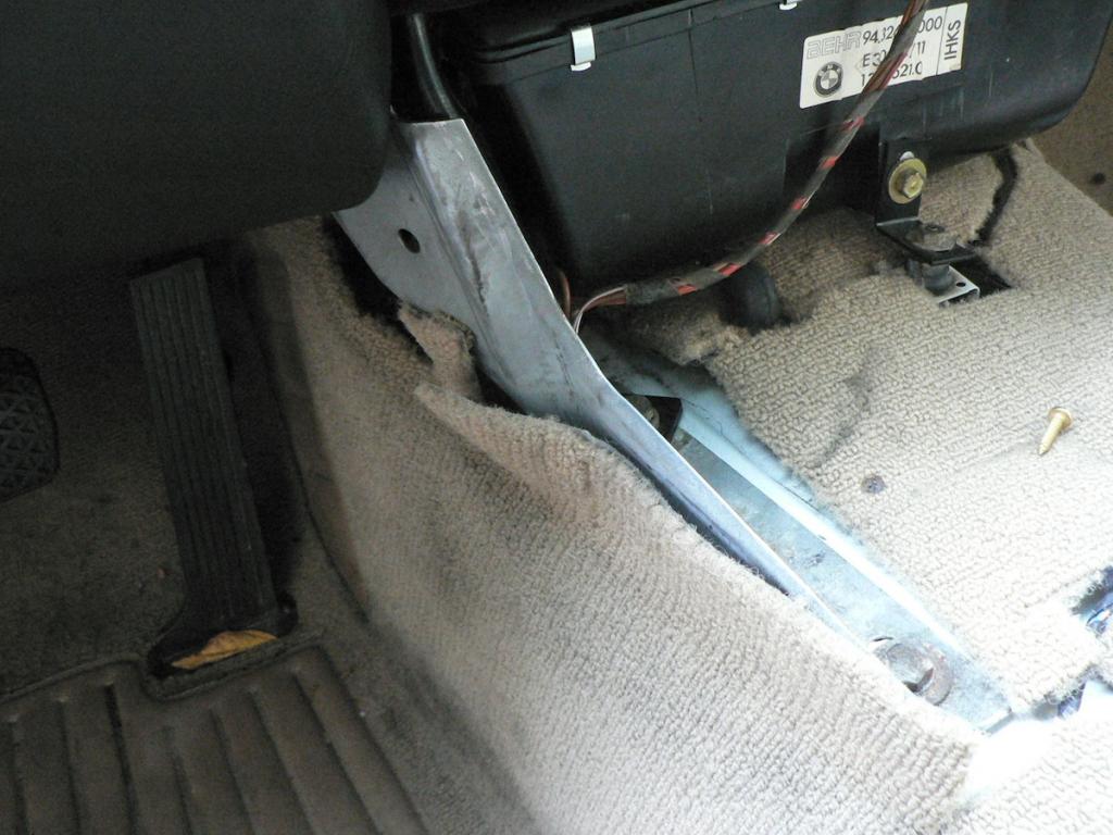

          The only part # diff I can find is A/C versions, anyway here is a pic of what the piece hits when I try to install. WTF?
          In the second pic you can even see the small pile of foam from me effn with it. Do you guys have this same piece of metal?
          • oldmann
            • Oct 2011
            • 265
            I don't have that piece in my 91 318i.
            • bmw325csi
              • May 2007
              • 4045
              airbag models are different than non air bag models. The airbag knee bolster has a bracket which the is under the console. You can make it fit with some trimming
              harry/harout
              • E30_Pare
                • 7801
                Da fug is that. Never seen that before.

                • sfinsf
                  • 246
                  Trimming of the partition?

                    • sfinsf
                      • 246
                      If I trim much more I'll come right thru the thing...
                      • unevolved
                        • Nov 2011
                        • 714
                        That bracket looks a lot like my 91 318i.

                        • MR 325
                          • 37828
                          You have a 84-87 console. You need a 90-91 (airbag) console.
                          Classic BMW Specialists
                          Grover Beach, CA
                          www.BimmerHeads.com
                          • sfinsf
                            • 246
                            Thank you Sir!
