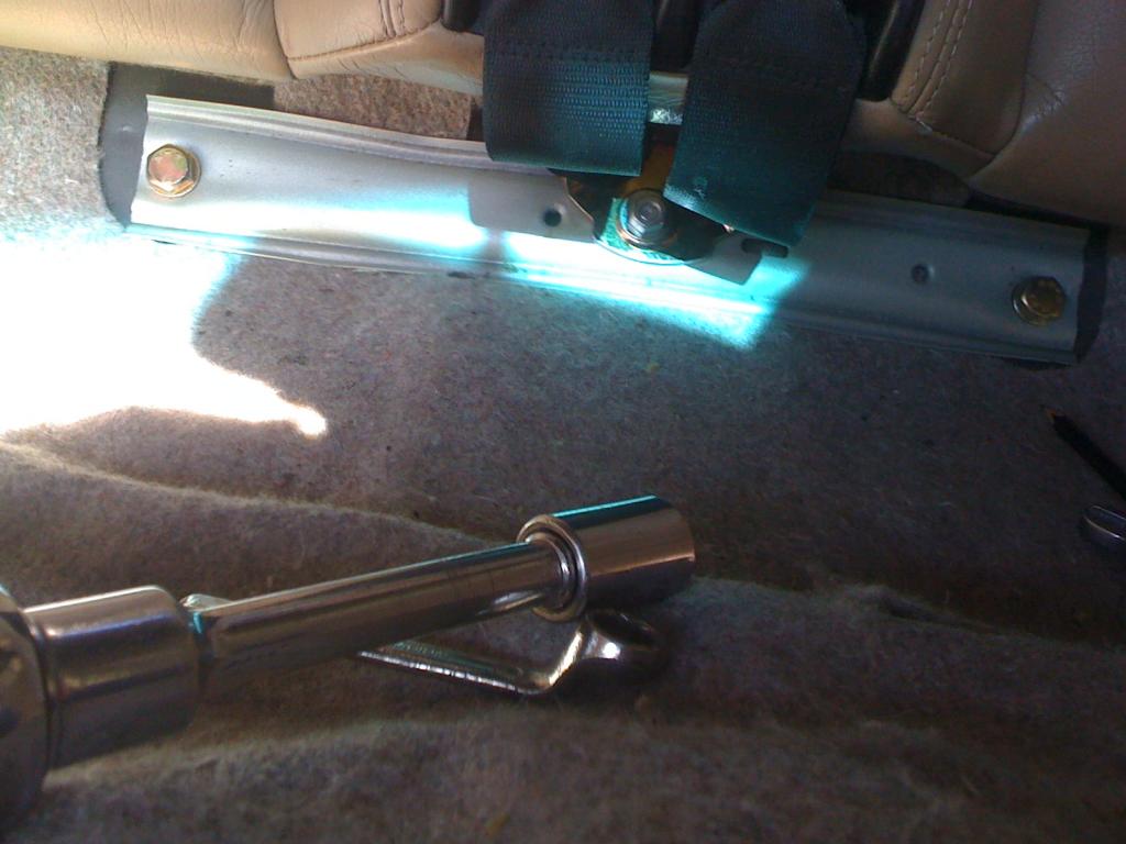

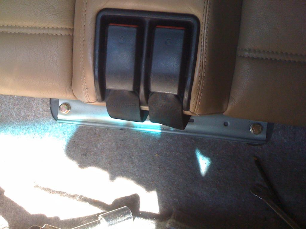

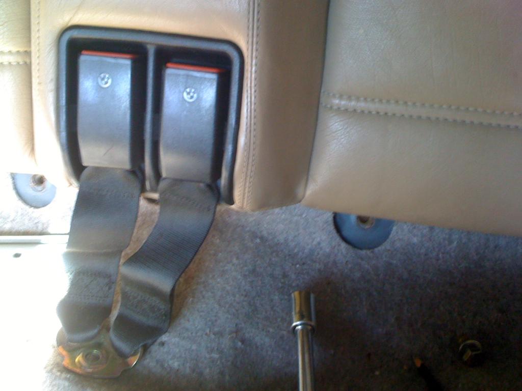

            My seat was unbolted already and my vert was in the garage so figured I'd help. Pictures are from an '89 vert. (click for full size)
            Here's just the picture you already have but just to make sure my car's the same:
            Here's what you want:
            Just for reference again (far right hole):
            To get the height I tried my best, I lined up the tape measure with the crease and pressed it down flat then let go for the pictures:
            Two seat mounts:
            Seatbelt:

                    Thanks a bunch! That's good enough to do what I need.
