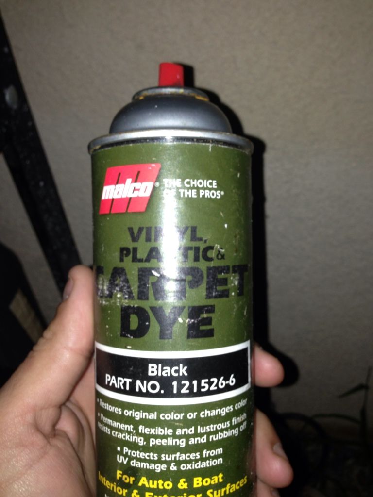

                    • bmw325csi
                      • May 2007
                      • 4045
                      I've had great success with this stuff for everything from consoles to steering wheels and even a tire that was dried from the sun.
