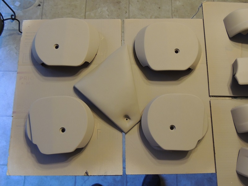

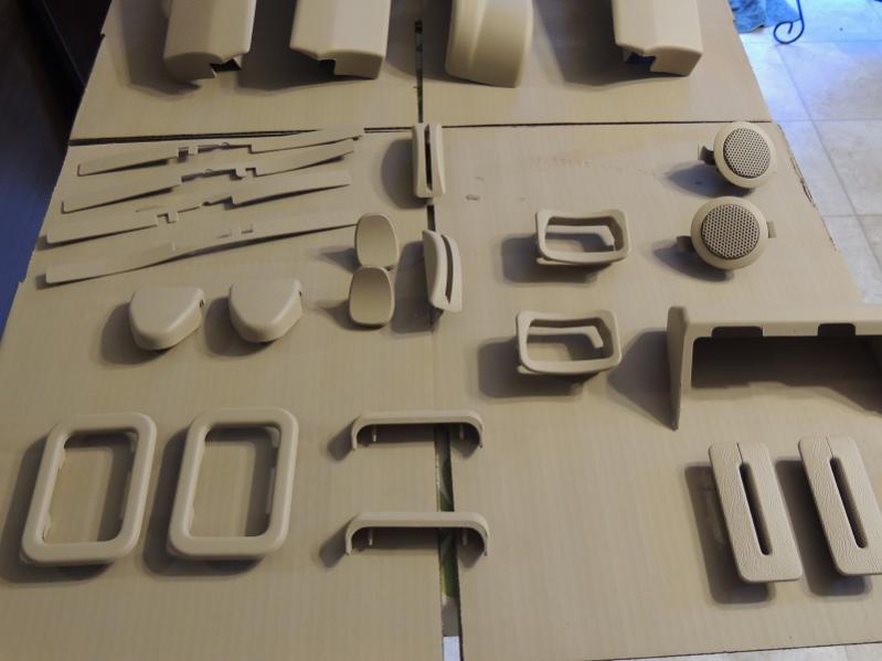

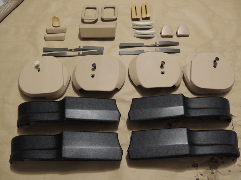

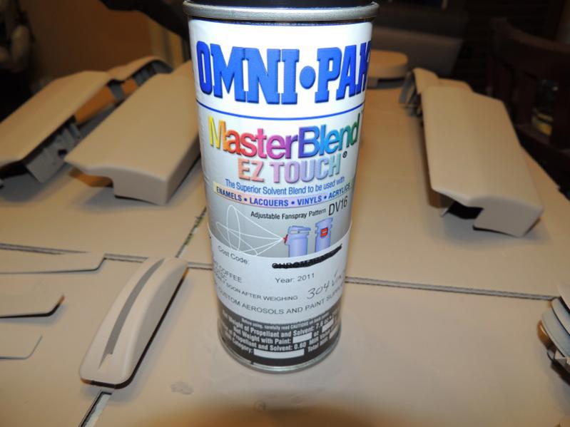

            I did all of the leather (Natur) in my 1987 E24 M6 last winter using Leatherique and I too struggled to find a corresponding paint for the few plastic pieces that wasn't slightly darker or lighter.
            What ended up being my perfect solution was taking a freshly dyed leather piece to my local auto paint shop where they scanned and color matched a few cans of spray paint with the proper adhesion promoters for plastic. It ended up a perfect match.

                Thanks. I lived your frustration trying to track down a color that was "close" at all the major retail stores and just wasn't satisfied.
                These weren't cheap at $21.00 per can but, they were a prefect match. And with all the leather in my M6 I only used two cans for the plastic bits, the leather was re-dyed using Leatherique.
