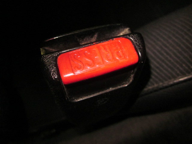

      It took me a lot longer to get this done than I thought it would. I finally got the petroleum jelly or vaseline to try restoring a spare seat belt receiver I had before trying it on the receivers in my car.
      It works great and is definitely the way to go. I took several before and after pictures so you can see for yourself.
      First, here's what I did:
      1) I cleaned the receiver with a Clorox wipe. It took some time because the button was a bit dirty but you'll see from the picture I got it pretty clean. I let it sit overnight in case the cleaning softened the plastic of the receiver before treating with the petroleum jelly.
      2) I put a light coat of petroleum jelly on the plastic and used a q-tip to get it on the edges.
      3) It seemed like the petroleum jelly was absorbed by the plastic and there were still some spots so I added a nice thick layer. After a couple hours, the plastic looked much better and the spots were pretty much gone so I wiped off any excess.
      As an alternative you can take a look at another solution to this problem with similar results here:
      But before you go to the other link, take a look at the before and after pictures for yourself. I plan to do this to the receivers on my front seats in the car.

          I used my Zinno touch-up paint and it looks perfect.

              Noticed this one needs another coat as it's beginning to wear a little.

                Looks great! How long did the paint last before showing signs of wear?
                • TrentW
                  • 2815
                  Been almost 5 years
