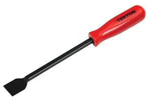

          Extracting the frame from the foam was an absolute pain in the ass. It wasn't neccesarily difficult, just time consuming because you couldn't just pull the foam or it would tear off in random chunks. I was usually a bare razorblade at first but found that a solid gasket scraper worked best. just like this;
          After I got the foam completely off it was fairly easy to see the breaks. It obviously had been broken for a long time and almost had broken completely in half. A little welding and now I'm going to reglue the foam and stuff it back into the cover.
