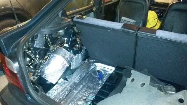

              Did this sound insulation recently on my 318ti. I went for about 80-90% coverage on the trunk and rear seats; I didn't even use a whole roll. It may be a placebo effect but I think noise was reduced by a few decibels. For example, at 75 MPH, I no longer need to raise my voice to talk to the passenger.
