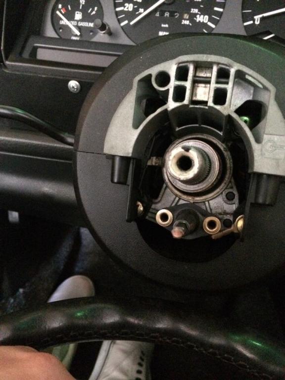

          Where in the photo are the rivets? Click image for larger version

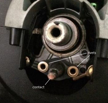

            Also can u see the carbon pin in this pic?
              the carbon pin is right beneath the bolt that holds the steering wheel in place, the rivets are the two holes on the side of it
